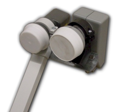

On 18 inch was able to have 119 in center and 110 on right on the bracket (on left as you face the dish)
Replaced with 30 inch dish to get 119/118, have to put the 119/118 LNB in the center, however to get 110 signal, the 110 LNB on the right (on left as you face the dish) has to be to be lower than 119/118 by 1.5 inches and also has to lean more towards the dish than the bracket provides.
My problem is with my bracket which worked fine for 18 inch dish, the bracket cannot hold it in position 1.5 inches lower as needed for the 30 inch dish.
I cannnot skew the dish, is there a bracket for 30 inch dish or do I have to put that LNB on the old 18 inch dish?

Dual LNBF brackt for 30 inch dish
$13.95
