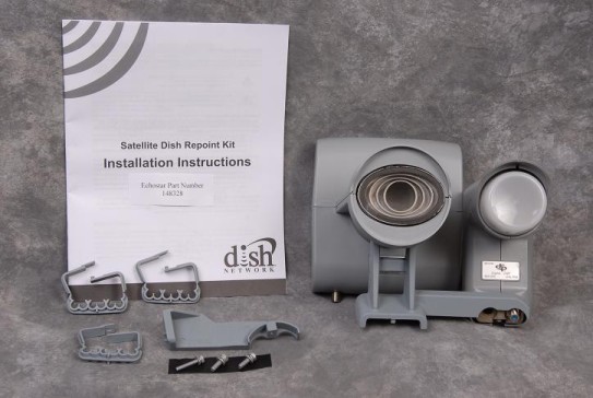

Could anyone identify the LNB types in this photo?
Username: Locnoir
Post Number: 39
This sat kit was installed by DN. I have a converted PS2700 and receive 110 and 119. Could I get 118.7 Anik F-3, and what would be the setting? I live in the south east. Thanks!
Username: Billybeerboy
Bad streetUnited states
Post Number: 79
This is dishes superdish.The 2 lnbs together are for 110 & 119 the one off to the side is for local channels.
Username: Scabz
Knoxville, Tn Us
Post Number: 276
I would rather have the dish 1000.2 and the dishpro plus lnb.
Username: Locnoir
Post Number: 40
Thanks, Bill! Could anyone tell me how to get 118.7 (Anik F-3). What would be the setting? Thanks
Username: Madflea168
Post Number: 13
I was asking a similar Q in another thread, what you will need is probably gonna be a new repoint kit(LNB) which allows you to upgrade your superdish in order to receive 110, 118.7 and 119
the cost is probably around $100 as I checked.
Username: Locnoir
Post Number: 41
Thanks, Madflea! I would appreciate of getting the detail and instruction for the new repoint (LNB) kit.
Username: Tale
Post Number: 122
Registered: Sep-07
This looks to me as setup of 129 in the middle( HD) , 119 and 110 . I might be wrong.}
Username: Tale
Post Number: 123
Registered: Sep-07
In the middle I meant the on pointing the center of the dish -so the right one that looks different.
Username: Tapeman
New York City in-HD, NY
Post Number: 2048
I'm almost certain this is an HD/SD/International
4 Satellites dish
110/118/119/129
To get 118 need to create a new Sat call it Anik
Set first tp
Edit tp
f= 11715
pol= V
fec= 7/8 or auto
Set LNB to standard
Do blind scan
If yo do LNB to Universal yo can set both 118/119 with same scan
Standard or Universal means Internal Osc preset frequency that controls modulated frequency off the satellite
Standard= Standard Ku = 11700 to 12200
Universal= 11700 to 12700
Internal Ocillator is usually 1000 to 2000 less

Username: Pulp_fiction
Post Number: 935
Registered: Nov-07
It's a
SuperDish 121-119-110
Username: Locnoir
Post Number: 43
Pulp, can I still do the Anik setup per King Tapnman's instruction? Thanks
Post Number: 936
Registered: Nov-07
Well the lone is for 121 the dual is for 119/110 respectively. The spacing is a constant. I think it's nearly impossible to postion them in a 119-118-110 configuration.
Username: Tapeman
Post Number: 2055
Pulp Fiction is the least experienced member here
Loc
Assuming Dish was installed by a pro installer and was working at one point in time
If yo look in front of dish
Too much space between LNB on Right and LNB in the Middle
Absolutly not 2 degrees apart
There are rules of thumb to follow
High order satellite orbit location LNB on right
Low order satellite orbit location LNB on left
Therefore it has to be 110/119/129 with the possibilty 119 is 118/119
If yo do what I told yo above and it doesn't work
Then yo need to change LNB to get 118

Username: Nydas
Post Number: 6972
Loc Noir : In the final analysis, you could either buy the kit from DN or buy a separate non-DN Universal LNB and non DN 110 LNB and with some effort and perhaps a new bracket, you would have 110W,118.7w,119W combo.
You decide whether or not you want to do all this with DN kit or DIY effort. Have you considered 97W (Galaxy 25) in your equation?
All this is new direction and all of us are somewaht novices at it.

Username: Tapeman
Post Number: 2058
Loc yo got more experience than pulp fiction
Just completely disregard his advice
Noob is a noob
It is not impossible to get 118 on a super dish
119 LNB can pick 118/119 if it is a universal Circular LNB
First thing first
LNB on the right is not 105
I'm certain it is 129 HD
Twin pack is 110/119
If yo replace 119 circular to a Universal Circular
Then it will pick 118/119
I'm suspecting one of the twin LNB either 121 or 118
The only way to know is to scan like I told yo
If yo replace it without knowing what it is...then yo missed the opertunity to be up and runing in few minutes
So once again
Out of the twin pack (one in middle LNB)
Scan it with above information and see what yo get
BTW
If yo tell me what month and year it was installed this can give me more clues
I can get yo up and runing in a matter of minutes

Username: Tapeman
Post Number: 2059
Disregard the Noob, he's in the wrong place
Loc
In 2005 there was no 118 FSS
Therefore what yo got is most likely 105/110/119 or 110/119/121 or 110/119/129
https://www.ecoustics.com/cgi-bin/bbs/show.pl?tpc=2&post=961934#POST961934
My stuff is always timed and dated
Did yo order International at one point in time?
Most likely only one LNB to be replaced
But reading what's on the LNB or what service yo had helps to know which LNB to be replaced
LNB yo'll need is a Universal Circular or Invacom Quad pol
Yo may also purchase 118 kit off e-bay or DN like Nalin told yo
But yes yo can get 110/118/119 with your dish
Don't listen to noobs like pulp fiction

If I could chime in here a tad, not indicating that I am an expert, but, how about an offset 30" with an HH rotator, a QPH linear / circulator LNB and a little patentients aiming it to the clarks belt? I did my time doing this but aint getting 61 and 148 on either end just yet but poking at it.

FSS is a 100W low power beam (require 30" dish)
DSS is a 200W high power beam (require 20" dish)
FSS is usually Linear 11.7G to 12.2G Hz
DSS is usually Circular 12.2G to 12.7G Hz
But DN did something brilliant they combined low power FSS and high power DSS on ONE LNB both beams come from 2 Sats and can be scanned with one Universal LNB capable of both frequencies both are circular polarities Full Freq sweep 11.7G to 12.7G
Yo can easily scan FSS and DSS with one 28" to 30" dish
But it is not as easy to scan 2 FSS on one 30" dish
For example FSS 93/97 on one dish require 36" dish
Or FSS 97/101W on one dish require 36" dish
And also FSS 101/105W require 36" dish too
2 DSS on one dish piece-a-cake
1 DSS and 1 FSS on one dish no problem
2 DSS and 1 FSS on one dish absolutely no problem
3 DSS and 1 FSS on a 30" dish can be done too

Loc Noir original ? was asking about identify the LNB types and if he could use them to
pick up 110-119-118...
well u started telling him the dish was
"I'm almost certain this is an HD/SD/International
4 Satellites dish
110/118/119/129 "
which was totally WRONG!

I posted picture showing u a superdish just like his used for picking up 110-119-121..
Yet u still went on and on that it couldn't be done...
Then Loc Noir posted date of install and I also noticed he said in a message now
"local channels and a DN channel indicating dish 500 and sat 105"
which means he has a superdish 110-119-105 which I began to think of after he mention the install date..
Which means he could be up on the roof until cows come home and still never beable to set the dish up for a 110-119-118 configuration. Unless he modifies the bracket for the outside linear lnb like that of a offset which would mean a decrease in the quality of both the 110 and 119 lnb's be cause of trying to set the focal point on a 119/118 split due to the fixed spacing of the 110/119..

Loc Noir
bill says that the single LNB is for
local channels, I don't think so.
110 carries lot of local channels.
This single LNB could very well be
for Bird 121. just replace it with the
new 118.7 LNB or with this converting Kit.
This kit converts a SuperDISH 121 (121, 119,110) to a DISH500+ (119,118.7,110).
Includes LNBF for 119 & 118.7 and a Dishpro Single for 110. It also includes the bracket for 129, however you will need to purchase the additional LNB and appropiate switch Upload
Post Number: 30
thanx, Yukon, I ordered the kit last week, thanx for confirming my doubt.
