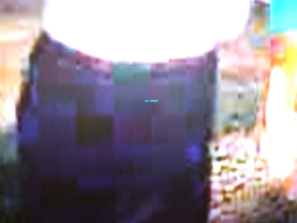

New member Username: FjgPost Number: 2 Registered: Jan-07 | Attached are some images of the problem I listed above. Ideas? Return it or call service? ![]() |
New member Username: FjgPost Number: 3 Registered: Jan-07 | The rest of the story... I called Samsung. The phone rep was polite and had me attempt a reset (unplug, press power 3x, hold power 30 sec, replug), but there was no change in status. He gave me the number for a local authorized repair center and a warranty reference number. I called the local repair rep, and after I described the problem, he recommended I return the unit for a new one at place of purchase. He beleives it's the DLP mirror chip or the digital controller board. He said if I wanted him to repair something like this, he would take it to his shop, diagnose, order parts, fix, and calibrate. I don't want to be without my new toy for that long -- especially with the superbowl a couple weeks away! So, I went to the local retail store to talk about exchanging it for another. I took the above pictures with me to show them the problem. They agreed to exchange without any complaint. However, the model is not in stock at any of their 3 Las Vegas area or even S. Cal stores, and 4 are on special order waiting to be filled! They offered me a pretty good compromise: keep my set with the minor annoyance, and when a new set arrives, they will deliver the new and fetch the defective one. They said if I get tired of waiting and want a refund, no problem, even if it's past the 30-day return window. (I just need to make sure I keep the box and materials.) I get to keep her around a couple more weeks, so if anyone has a troubleshooting idea -- please let me know. PS -- I found some settings for the HL-S6187W at another forum. Although not a professional tweak, these settings were a marked improvement over the factory settings: Mode: Movie Contr: 40 Bright: 45 Sharp: 0 Color: 45 Tone: Warm2 G50/R50 DNR: off DNIe: off Cheers! |
