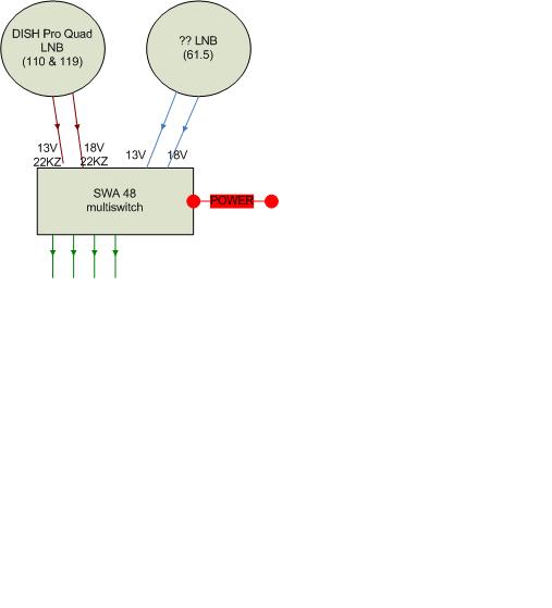

Bronze Member Username: New_member098Post Number: 37 Registered: Mar-07 | Here is what I'm shooting for - 1) I need 110 and 119 from one single DISH with at least 2 line of output each carrying signal from both sats and. Based on what I read so far, it seems I can use Dish Pro Quad LNB, although, it has 4 line of output, all I need is 2 lines. Please confirm if that is a right understanding. Also, Can I mount this Dish pro Quad on a DTV Dish? 2) I also need 61.5 with again at least 2 lines of output each carrying same signal. Now, I do not know which LNB is most suitable for this. 3) The reason I was looking for 2 line from 110&119 dish and 2 lines from 61.5 dishes is because I have in all 4 lines running to my basement to a central distribution location. Here I have a SWA48 (DirecTV certified) multiswitch that gives output for 4 rooms. I'm assuming in my Pansat 2700a I can configure like this to get all three sats -- 119 with DiseqC = 1; 22Kz ON; Dish type = Standard/ DISH Pro?? 110 with DiseqC = 2; 22Kz ON; Dish type = Standard/ DISH Pro?? 61.5 with DiseqC = OFF; 22 KZ OFF; Dish type = Standard/ DISH Pro?? Please help! ![]() |
Gold Member Username: TapemanNew York City in-HD, NY Post Number: 1864 Registered: Oct-06 | 2 simple DISEqC switch would of done the job 22k Switch don't have to be on at all DTV usage are not the same as DN |
Bronze Member Username: New_member098Post Number: 38 Registered: Mar-07 | can you draw a picture and show what is that you talking? |
Gold Member Username: TapemanNew York City in-HD, NY Post Number: 1868 Registered: Oct-06 | ![]() |

Gold Member Username: RtapFL Post Number: 1191 Registered: Jan-07 | correct me if i am wrong but i think the dish pro lnb has four output for four different recievers.the dish pro lnb has a built in switch that allows your reciever to switch from 110 to 119.i believe the 119/110 numbering is confusion but the diagram by king is correct.good post king. |

Gold Member Username: TapemanNew York City in-HD, NY Post Number: 1872 Registered: Oct-06 | In Antenna sttings Yo have to match hardware switch 119/110>>>Port-1 61.5>>>Port-2 |

Bronze Member Username: New_member098Post Number: 39 Registered: Mar-07 | King Thanks for the picture. But how do I get 4 lines of output each carrying all three sats?? |
Silver Member Username: WakenbakePost Number: 358 Registered: Mar-06 | get a dp34 switch |
Gold Member Username: TapemanNew York City in-HD, NY Post Number: 1877 Registered: Oct-06 | Sw-64 or DP-34 Check this thread https://www.ecoustics.com/cgi-bin/bbs/show.pl?tpc=2&post=1327491#POST1327491 There is always obstacles Make sure yo use modern receivers |
