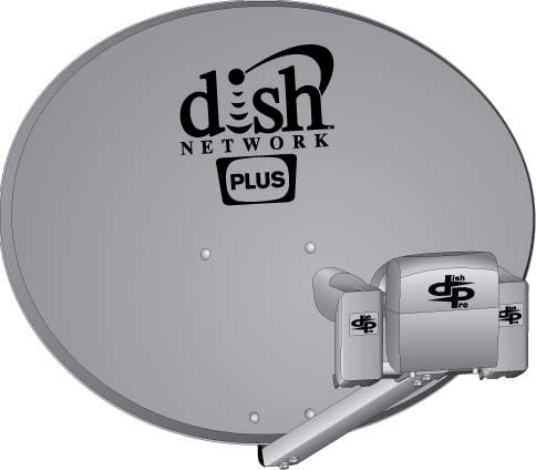

Something like this?

speaking of dishes,i found a 39in with a linear lnb...if i put a circular lnb on it would it be ok for echo...its not absolutly round,kinda egg shaped top and bottom...digiwave i think...
Username: Lklives
Post Number: 13513
Thats the 1000 plus, like I mentioned above...
Dish 300
Single slot 18" round DBS dish that can pick up programming from one DBS satellite location at a time. DBS locations for Dish are 61.5°, 110°, 119°, 129°, 148° and (not used) 157°.
Dish 500
A two slot 18" x 20" DBS dish designed to pick up 110° and 119° simultaneously. However it can be used to pick up 119° and 129° or just one satellite location like 61.5° or 148°.
Dish 1000
A three slot DBS dish designed to pick up 110°, 119° and 129° simultaneously. This dish can be used to pick up 129° and 148° simultaneously.
Dish 1000.2
Slightly larger than a Dish 1000, its integrated head unit has 3 LNBs (110°, 119° and 129°), an input for a 4th LNB, and DP Plus switching to 3 receiver outputs.
Plus Dish 500+/1000+
Same as the Dish 1000 in function but about 5" larger and can pick up the 118.75° FSS location. As a 500+ it picks up 110°, 118.75° and 119°. Adding an LNB for 129° makes it a 1000+.
SuperDISH
105: Specifically designed to pick up 105°, 110° and 119°
121: Specifically designed to pick up 110°, 119° and 121°
Dish Size Mast Use Alternate
Dish 300 18" round 1-5/8" One DBS slot
Dish 500 20"w x 22.5"h 1-5/8" 110° & 119° One DBS slot,
119° & 129°
Dish 1000 23"w x 18"h 1-5/8" 110°, 119°, 129°
Dish 1000.2 25.9"w x 20.7"h 1-5/8" 110°, 119°, 129° Input for 4th slot
Plus Dish 30.9"w x 23.8"h 1-5/8" 110°, 118.75°, 119° Add 129°
SuperDISH 33.3"w x 24"h I: 2"II: 2-3/8" 105°, 110°, 119°..110°, 119°, 121
