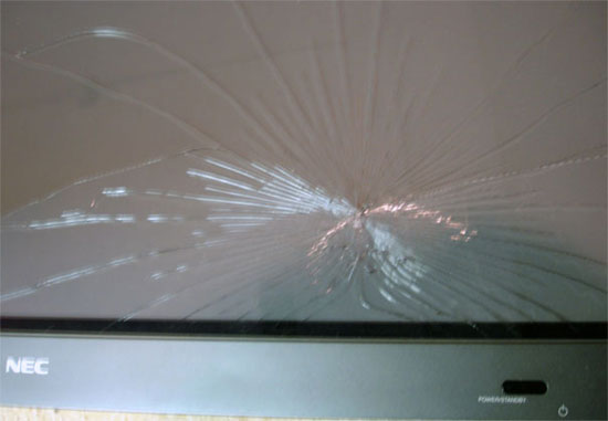

BigJoe11 Unregistered guest | well, once the vaume is broken on the plasma its pretty much junk. You can buy a new plasma tv from plasmahouse a really cheap price. |
Unregistered guest | All plasma displays are constructred somewhat like a standard crt [cathode ray tube], in that they are a sealed glass envelope under a vacuum. But a regular crt is a much thicker design and will take being hit [on the face], such as a bouncing baseball,etc. I have seen a crt hit hard enough to cause the shadow mask to become dislodged, resulting in poor color, but still work ok in every other way. The sealed glass construction of a plasma display is much thinner and cannot be bumped or jarred, without cracking it, which results in a loss of vacuum and a worthless display that can only be replaced as a complete assembly. So when there is a cracked display, all you have is junk. Most plasma displays approach the cost of a completely new monitor, which is why an lcd or dlp monitor [more physical durability] makes more sense, overall. |
New member Username: PalongePost Number: 2 Registered: Jul-05 | About cracked front glass on plasmas your being given VERY BAD information. People! Do not listen to Ron Tozier's posting on Aug 31 or any others that state the same doom and gloom. Read how I had my screen fixed from my July 27th post. As for that loss of vacuum statement- that is a complete myth- at least as Panny's go and can't believe there is such a different construction by other MFGs. There is no vacuum involved between the front glass and the actual panel behind it! I know I watched the repair techs disassemble the whole TV in my house and there is just a foam gasket to prevent dust from getting between the panel and the froant glass- end of story. |
