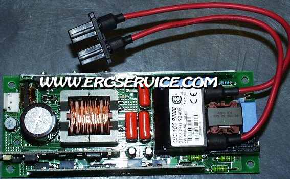

Which samsung model do you have? Is this the ballast that they repleaced you?:
There must be a short-circuit or overheating inside the housing... This is not normal...
