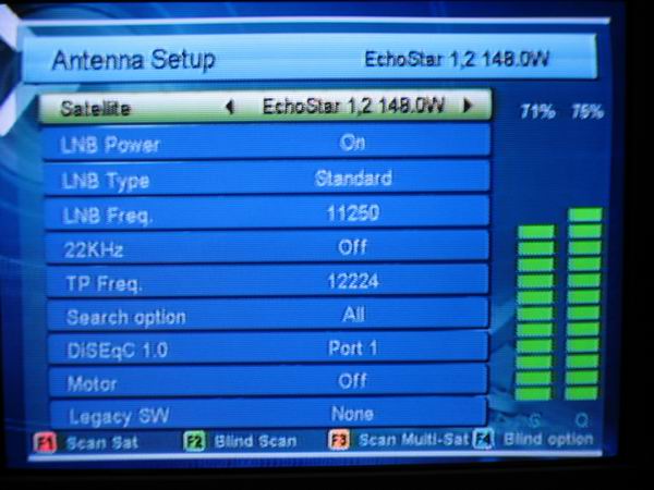

Carmen Melendez
No se si esto es lo que quieres?
To Start : Download...... Loader2 , Latest File , also Latest Opkey File.
1. Unzip the files in all folders and Extract , Then save on desktop.
2. Click on the program "Loader2"
3. Click "Open Files"
4. Go to the directory(Desktop) where you saved the files and select The Main file ( or Opkey File )
*(This file name will Change with new versions. Just make sure its the .PGM file)
5. Click on tool, Click on configuration - select comm port
6. ( Main Power to Unit should be OFF B-4 you click PC->STB ) Now click PC->STB......After you click turn ON main Power in back of Unit.
(You should see the Files loading properly)
7. Once it is completed, The program will say its done. Now wait for the Viewsat to say "End" then "0000" on the front display THIS IS CRITICAL!.
Repeat steps 4- 6 for Opkey file.
8. Read Your User Manual.
IF you have a DP LNB then this is your setup.
110:
LNB power on
LNB type OCS-DP
LNB freq 11250
22khz OFF
TP freq 12224 ( If quality is not Good scroll right or left 4 better Quality bar ) Not really Neccesary....
Search option ALL
Disecq port 2
Motor off ( Press F1 to Scan Sat )
119:
LNB power on
LNB type OCS-DP
LNB freq 11250
22khz OFF
TP freq 12224 ( Same as above Scroll right or left ) Again , not really neccesary....
Search option ALL
Disecq port 1
Motor off ( Press F1 again to Scan this Sat )

Te vas a instalacion y después a ANTENNA SETUP y estos son los parametros que deberan estar:
DISH 110
LNB STANDAR
FRECUENCIA 11250
22KHZ APAGADO
DISEQC EN 1 ( EN CASO DE NO TENER OTRO PLATO PONER APAGADO)EL 110 VA EN EL DISEQ1 Y EL 119 EN EL DISEQ2
TP ES EL TRASPONDER ( VERIFICAR CUAL TE DA MEJOR CALIDAD )
AJUSTE EN DETENCIO
REGISTRO TODO
DISH 119
LNB STANDAR
FRECUENCIA 11250
22KHZ APAGADO
DISEQC EN 2 ( EN CASO DE NO TENER SW PONER APAGADO)
AJUSTE EN DETENCION
REGISTRO TODO
El password de los equipos es 1668 O PUROS 0000por si te lo pide en algunas opciones de configuracion personal.

Username: Eddyc
Lancaster, CA USA
Registered: Aug-07
Hola amigos, Alguien sabe que echosat puedo recibir desde el balcon de el apartamento, tengo vista hacia el norte 90 grados al este y al oeste, no puedo recibir el 119 y 110, estaba buscando el echo 3 que tiene la programacion en espanol pero no lo encuentro, probe 61 grados noreste. Si alguien supiera que satelite puedo recibir se lo agradeceria, tengo un Pansat 2700a y un dish 500 o dish DTV

Username: Rober2154
Miami, Fl Usa
Post Number: 178
EDDY CRUZ; el Echo3 yo lo tengo y lo encontras an 142 grados y 54 de elevacion, tambien desde tu balcon podes conseguir los dos NIquim me parece, yo los pesco con un dish de DTV. Pero para estar seguro entra a este site que te ubica mejor. http://satcalculator.freehostia.com/
