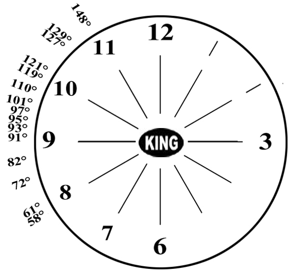

i currently have a dish 500 satellite getting 110 and 19 how doi go about getting bev i have another dish i can use but where do i find the satellite angles i need and im using a pansat 3500 anything special i have to do with the reciever to get the signal

If you are getting DN 110/119
BEV is only 18 degrees counter clockwise
or 18 degrees towards east
If 110/119 slightly before 10 O'clock
82/91 is around 9 O'clock

Once you have your single dish pointed. You want to scan Nimiq 1,3.
