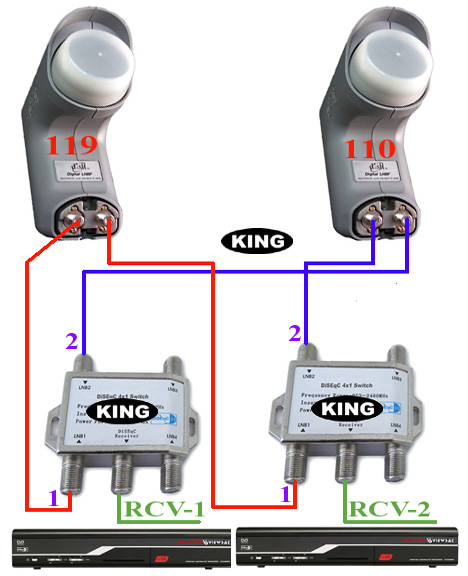

Gold Member Username: TapemanNew York City in-HD, NY Post Number: 1076 Registered: Oct-06 | "pretty big one" If you play with your LNB it will get pretty big that is normal ![]() ![]() I assume it is the twin LNB for 110/119 You can get both birds with one coax wire Set each sat to a DISEqC port Scan one Sat at a time |

Gold Member Username: TapemanNew York City in-HD, NY Post Number: 1077 Registered: Oct-06 | Arni Circular Dual LNB (one LNB with 2 outlets) for 110 Twin LNB (2 LNBs with 2 outlets) for 110/119 Same for you BetterOffRed 2 outlets (1 for each receiver) ![]() |

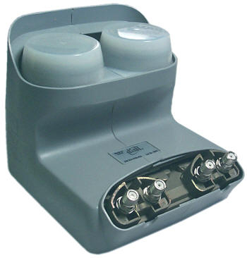

Gold Member Username: TapemanNew York City in-HD, NY Post Number: 1078 Registered: Oct-06 | Yes from DN This is the Twin quad Twin dual looks like the twin quad with 2 outlets What is nice about it is one wire needed for each receiver very easy to use ![]() |

Gold Member Username: TapemanNew York City in-HD, NY Post Number: 1079 Registered: Oct-06 | Twin dual you run one coax straight to receiver No switch needed Twin has internal switch I recommend you use RG-6 check this section for wirring https://www.ecoustics.com/cgi-bin/bbs/show.pl?tpc=2&post=1080851#POST1080851 In antenna setup: 110 DISEqC port-1 119 DISEqC port-2 Scan each Sat seperately one at a time Twin LNB You can pick one very cheep from e-bay or google for Satellite website |
Bronze Member Username: XarnixUSA Post Number: 26 Registered: Oct-06 | thanks KG, So you are saying if I use dual LNB I dont need switch. |
Gold Member Username: TapemanNew York City in-HD, NY Post Number: 1080 Registered: Oct-06 | That is correct |
