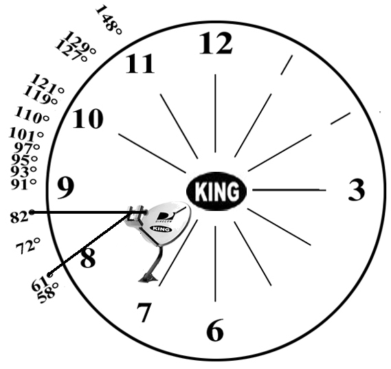

Can be used to get 2 Sats
1-BEV at 82 and 1-DN at 61.5 for international
This type of dish is designed to get 101/119 which about 18 degrees apart. Almost about the same distance between 61/82.
The alignment must be bulls eye but will work
This is not for a nubie.
The trick is you have to align so perfectly to 71 or 72
Skew: can be just a bit challenging when doing 2 Sats. Hard but not impossible.
The reward is you'll get 2 for the price of one
Let me know if got questions
King
Note:
Sketch is for Satellite Orbit location after Reflection from dish
i.e. If looking in front of dish:
Right LNB is 82
Left LNB is 61.5
