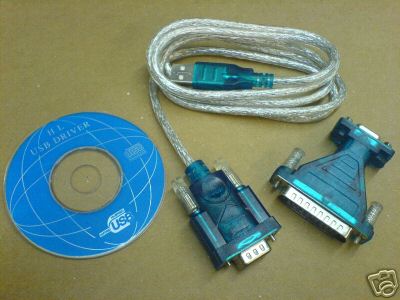

Bronze Member Username: Saqeeb90Post Number: 30 Registered: Dec-06 | hi i bought this usb to Rs232 cable. i am trying to download it on my megaset4000 reciever. i am using coolset pro loader. it detects my port but my reciever cannot update the file. it cannot update any file. my usb 9 comes with software cd i already downloaded. is there anything i can do to update that reciever |

Bronze Member Username: Saqeeb90Post Number: 35 Registered: Dec-06 | any one can show me picture of RS 232 cable that works with my laptop pls help |

Bronze Member Username: LokbongtomPost Number: 25 Registered: Jun-06 | This one did not work at all with the FTA :http://cgi.ebay.ca/USB-to-RS232-Serial-DB9-9-Pin-Cable-Adapter-Garmin-GPS_W0QQit emZ270099983282QQcategoryZ41995QQrdZ1QQcmdZViewItem This one work but with XP you need to force to install manually two driver difference :first install the .exe file from cd ,reboot you pc ,plug the usb to serial cable XP will ask you the driver ,you have to select the driver from the cd and force its to install, it will work 100% with your FTA. but repsect the cable nul-modem or straight depend on your model FTA http://cgi.ebay.ca/NEW-for-USB-to-Parallel-Serial-Printer-Adapter-Cable_W0QQitem Z290092230692QQcategoryZ11196QQrdZ1QQcmdZViewItem |

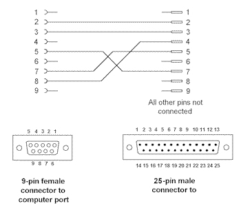

Silver Member Username: TapemanPost Number: 748 Registered: Oct-06 | That is the issue They convert USB to serial port They don't convert USB to null To use USB you must have Windows XP no driver required (don't even think about it if you don't have XP) If you are willing to test at your own risk. I never tried it. But what will make more sense to me. If you are willing to give it a risk: - Convert your printer port to 9 Pin Male - Then use null cable It should work If it doesn't work try using 9 pin serial cable with converter. If it does't work (forget it) {additional hard wires maybe required} Just get a LAP TOP that has null cable ![]() |

Silver Member Username: TapemanPost Number: 751 Registered: Oct-06 | I was talking about USB in XP operating system You can make 25 pin serial port to 9 pin serial port. It does require cable rewiring. I havn't open rs232 for nearly 22 years. Simple pin configuration but may not be simple to FTA users. |
Gold Member Username: LklivesPost Number: 8243 Registered: Jan-06 | I was just simply saying U do NOT need to have XP OS installed on your computer, if using the USB port and adapter with driver on your flash cable.. |

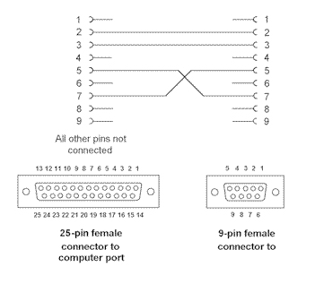

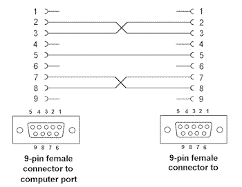

Silver Member Username: TapemanPost Number: 752 Registered: Oct-06 | Fine LK, thanx No problema 9 pin 9 pin female/female null This stu*pid null cable is nothing but 4 wires Not all pins even required Here is how and why: ![]() |
Silver Member Username: TapemanPost Number: 753 Registered: Oct-06 | Notice only 4 wires required in this case ![]() |
Silver Member Username: TapemanPost Number: 754 Registered: Oct-06 | Or 5 wires One of these has to work I just don't remember which one Be my guest if anyone interesred ![]() |
