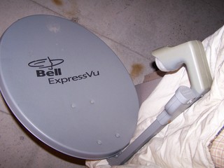

I'm going to buy a ViewSat Ultra receiver. Right have I have a StarCh* and a BEV satellite dish. I was told I cant do anything with my StarC*, but I can get something with the BEV I have.
I was told I can get either BEV, or DN satellite signal. One or the other. My Bev dish has only one LNB (not sure if its dual), but it has an expansion slot for another LNB..
My question is, how do I get BOTH bev and dn satellite signals? Can I just get another LNB for my BEV dish, stick it in the expansion slot and then I'm set, or do I have to get another dish to get both signals? .. so one dish for BEV, and the other would receive dn, OR I was told I can just take down my bev and get an Elliptical dish and use just that and get both signals. Is there any way to do change my bev dish so I can get both without buying another dish, or is that not possible. What dish/LBN is the best way to go?
My dish: http://img132.imageshack.us/img132/9907/1004021hb6.jpg
http://img214.imageshack.us/img214/7692/1004023eq2.jpg

Marcel, the dishes are pointing in different positions from bev to dn. like bev 91 and 82 sats, dn has 110 & 119. you'll need a second dish to point at one of dn sats.
look at this post:
https://www.ecoustics.com/electronics/forum/home-video/334504.html
with the ultra that u'll purchase, u'll get a switch which will allow u to go from on dish to the other. it also depends on ur location to get skew and elevation. also i've tried using the starch0ice dish and could catch the signal for bev with it. i don't think it works.

My friend says I need 3 LNB's to get both DN signals and the BEV signal (only one Bev signal is needed?)
Would this work? I use my BEV dish I have already.. take off that Y Yoke Adapter thats holding on to the LNB. I take the BEV LNB from it and buy two more LNBs. Buy a Quad LNB bracket.. hook up all three LNB's to it and put it back on my BEV dish. Then it should all be pointed in the right direction and work ok?
or do I still need an Ellipitcal dish and use that Quad bracket with 3 LNBs
-- I didnt think my Bev dish would work but on an ebay auction for the bracket it said "simply modify your existing Single BEV" so thats why I'm wondering now.

need a wider dish to get them...can get 91 on 1st lnb 110 on 3rd and 119 on 4th

It is nearly impossible to get 82, 91, 110 & 119 on one sat. You'll need a big dish and the setup will be a nightmare. You best bet is two dishes. One dish (such as the dish500) will be good enough to get two sats that are 9 degrees apart. Use either standard or single DishPro LNB's to accomplish this. Using DishPro Twin or Quad LNB's for the type of application you are going for is not recommended. Single LNB's have the advantage of using just about any switch. DishPro Twin/Quad LNB's have a built in switch which will cause you problems since your setup will be:
119 = 1
110 = 2
91 = 1
82 = 2
Which will cause a conflict when seting up.

if setup is so hard nearly impossible how come you can buy the dishes with the LNB's already installed? They are expensive and that's why I'm trying to do with what I got.
So the BEV dish is a no go which I figured anyways. I was hoping tho. The auction just confused me.
If I got a 33" ellipitical dish and tried that setup (but with single LNB's)would it work then? Its a much bigger dish.. I'm only going to use 3 LNB's which would only pick up 3 signals, not 4. (1 bev, 2 DN)
I just am trying to stay away from having 2 dishes if I can. Not only will it better in the backyard but also I live in a condo and we're really not supposed to have even one satellite dish.
I'm thinking I have to break down and get another dish eh?
