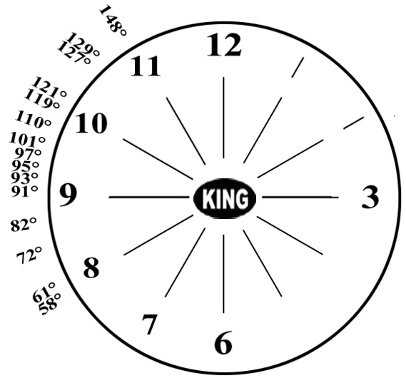

- NMQ 1 is 91°W
- NMQ 2 is 82°W
To get both easiest way:
Get dish 500 with Twin LNB one straight cable to your reciver or
any 18" dish or bigger will work (Circular LNB required)
- I hope you got a TV and an FTA receiver with a current Flashed BIN PGM
- Where is the location of the Satellite it all depends on your Geographical location
To get angle and degrees
1- Go to
[link removed]
2- Select NMQ 2
3- Select City, Providence near you
4- It will Calculate you AZMITH
5- Find true North and count degrees Clockwise
King's Clock can be used to reference location to all Sats out there
Have fun

Hey dave
Just use King's Clock, right under your post.
Let me know how you make out?

king if you wanna give the guy an answer do it with complete accurancie or dont .
if u seggest that dish500 can take both .
if 91 has elevation 39.8
82 has elevation 42.2
how the fucccccckkk u can do it . by guessing ?
needs to give the guy the elevation when you combine both in one dish . which usualy you add both elevation and you divide by 2
and you need fuckkkkkkkkkking skewwwwwwwwwwwwwwwwwwwwwww if there is one .
