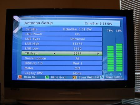

Bronze Member Username: Reddy7004Post Number: 20 Registered: Mar-07 | Here are details about my installation: I brought Viewsat extreme 2000 receiver and Dish 500 along with Dish Pro twin lnb's from TrussSatellite (auth. viewsat dealer) and I went to my friend home (70 miles away) and he installed .pgm file(bin file) and Opkey file. After successful loading into STB he hooked up my receiver to his dish's (he got one pointing to echostar 3 at 61.5 and other pointing to nimiq 2 at 91) and did blindscan for those two satellites (as I got the same view as him... South East). I came to my home and on the way I picked up another dish (used one) and my aim is to point to echostar 3 and nimiq 2 or 1. With you help and websites help I got all elevation and azimuth for both satellites and I tried to get singal using compass but was unable to get after few attempts then I took liberty to change elevations and azimuth and succeded partially to get signal and strenght. My setting are below 1. echostar 3 pointed at elevation 43.0 and azimuth 160 (true north) (these are supposed to be 41.7 elevation and 166.8 true north) 2. nimiq 2 pointed at elevation 50 and azimuth 190 true north (these supposed to be 44.1 and 198.3 true north) My location: Lat: 39 degrees 24 minutes Long: 76 degrees 47 minutes or Owings Mills, MD 21117 for nimiq 1 i should point to 42.1 elevation and 211.9 but this angle is exactly intercepting my house (in pic this angle is exactly my black grills and some roof is coming outwards so no clear sky for this angle) dish on grill with dual LNB is pointing to nimiq 2 and on floor is pointing to echostar 3 Intersting thing is Im getting nimiq 2 on both lnb's from dish that is on grill. Im using viewsat disecq/switch to connect both dishes (port 1 echostar 3, port 2 and port 3 nimiq 2 actually getting better signal from right lnb wich is port 3) I have adjusted SKEW (rotation) after getting signal to get more TP's and Quality and I would say in the given direction Im getting more TP's. As I said earlier Im getting TP's on 6227, 6256, 6286, 6315, 6344, 6373, 6577 for EchoStar 3 but not 12224, 12239, 12253, 12282, 12297.... 12661. and for nimiq 2 (from rightside lnb) Im getting on 12224....12661 but most of them are on TP's 6227.....6999 and this way Im mssing some channels. One thing you should keep in mind, my friend has wrong elevation say he put it on 30 degree which is supposed to be on 40 on both dishes but not missing channels and gettting signal and quality on TP's starting with 12... system settings are shown in pics. I tried to put dish perfect direction using compass but not getting anything (compass my be wrong on some degrees ) in that direction but Im happy as degrees are not too off. Please help in getting all channels and tell me how to get both nimiq 1 and nimiq 2 using dish on the grill. I was told that if I get nimiq 2 on the left hand side LNB, I can get nimiq 1 from right hand side LNB. ![]() |
Gold Member Username: NikkPost Number: 1460 Registered: Sep-06 | Reddy.... I should say you have a installation I have never seen before...... Ok, here's one thing... You have LNB's different than the Universal, your config indicates LNB Universal but there should be more options, for the kind of LNB's you have the set up must be OCS-DP instead of Universal. |

Bronze Member Username: Reddy7004Post Number: 23 Registered: Mar-07 | I changed it to OCS-DP and did satscan and I m getting different TP's and none of the TP's have signal and quality and got 0 video and 0 audio channels. By the way what is the difference between Blind Scan and Sat Scan on Viewsat extreme? |
Gold Member Username: NikkPost Number: 1470 Registered: Sep-06 | Blindscan is used to get from the sat the TP and channel info... SatScan will use the TP's pre-programmed info that your receiver has to scan for channels at those TP's... This time you changed to OCS-DP and did the scan, what TP number you got?? |
Bronze Member Username: Reddy7004Post Number: 24 Registered: Mar-07 | Goodnews on EchoStar 3.. Im getting all channels... more than 170 b/n 6000 to 7000. I had signal on most of the TP's b/n the above range but not quality on some TP's so I went to Channel Scan and Changed Polarity from 'H' to 'V' whereever needed and I got all channels covered including local channels. Thanks for your help. Now I should work on nimiq 2/1 dish... May be tomm. Talk to you guys later. Thanks |

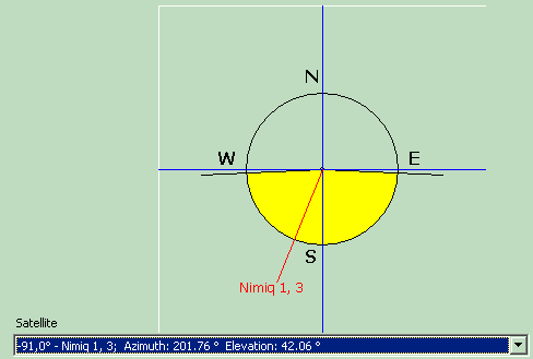

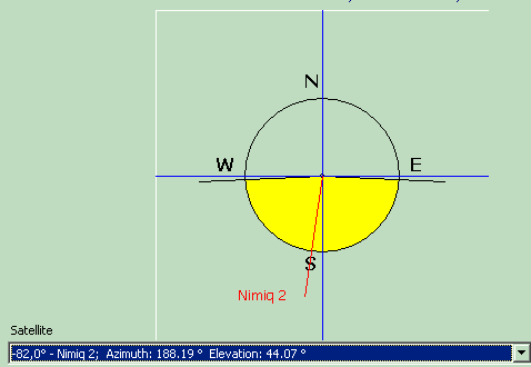

Gold Member Username: NikkPost Number: 1477 Registered: Sep-06 | Reddy... You are right on what you say, here are the graphic for Nimiq 1 & 2, notice the little difference in the elevation angle so you may need to tilt the dish a little bit... ![]() |
Gold Member Username: PrfrmnjPost Number: 2339 Registered: Oct-05 | Reddy - Find out what the lest expensive option. Buying a DP34 or buying two dual DishPro LNB's. Like the one you have on the second dish. If you use the two dual DishPro LNB's to replace the DishPro Twin then you can use your DISEcQ and it's a lot easier to setup for someone with little experience with the DishPro Twin Setup. |
Bronze Member Username: Reddy7004Post Number: 28 Registered: Mar-07 | Thanks for your suggestion... Does DISH SW64 works for me ? Becos Im getting this switch for less. Also, Can you advise on getting nimiq 2 and nimiq 1 (pls read above posts). The assumptions for getting second satellite (nimiq 1) channels if I point to one satellite (nimiq 2) is right ?? http://washingtondc.craigslist.org/nva/ele/290548142.html |
Gold Member Username: NikkPost Number: 1485 Registered: Sep-06 | ![]() |
Gold Member Username: NikkPost Number: 1486 Registered: Sep-06 | |
Gold Member Username: NikkPost Number: 1487 Registered: Sep-06 | ![]() |
Gold Member Username: NikkPost Number: 1488 Registered: Sep-06 | sorry...it went 3 times have no idea why... |

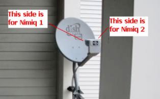

Bronze Member Username: Reddy7004Post Number: 29 Registered: Mar-07 | Thanks Nik.. If I am able to point left hand side LNB to nimiq 2 .. by default i get nimiq 1 from right side LNB ? or else do I need to set right side LNB to nimiq 1 so that by default I get nimiq 1 from left side LNB ? |
Gold Member Username: PrfrmnjPost Number: 2342 Registered: Oct-05 | Reddy - Nimiq 1 is 91 and Nimiq 2 is 81. That means that Nimiq 2 should be the one you point out as being #1 and Nimiq 2 the other way around. As far as the SW64 - It will not work with DishPro pro equipment. This type of switch is designed for standard (legacy) type LNB's. The easiest thing to do is to just get Single (dual output) DishPro LNB's like the one on your second dish and connect them to your DISEcQ switch. |
Gold Member Username: PrfrmnjPost Number: 2343 Registered: Oct-05 | Typo - I meant to say Nimiq 2 is 82 |
Gold Member Username: PrfrmnjPost Number: 2344 Registered: Oct-05 | But that only resolves half of your problem. You still need to address the Skew issue on your dish. If you don't set the Skew on the dish, you will not be able to get both. Because of the 9 degree separation between these Sats you need to tilt the LNB's in order to get both of them. For what I'm told, the Skew is pretty much the same for both sats. Because I don't know where you are located at, I can only give you proximate. The skew should be set between 115 and 140. But if you give me a zip code I could probably get you a lot closer. |
Bronze Member Username: Reddy7004Post Number: 31 Registered: Mar-07 | Thanks PRFRMNJ. I will look around to get DP34 or single dishpro LNB's ( I already had one as the used dish came with two single dishpro lnb's). I dont understand this sentance "That means that Nimiq 2 should be the one you point out as being #1 and Nimiq 2 the other way around. " can you repeat... sorry.... I m loacate in Owings Mills, MD 21117 (Lat: 39 degrees 24 minutes Long: 76 degrees 47 minutes) .. can you send exact elevation and SKEW for DISH 500. Is it possible to pickup nimiq 1 eventhough I have clear sky for half of the dish ? I appreciate it. |
Gold Member Username: PrfrmnjPost Number: 2349 Registered: Oct-05 | Nimiq 2 which is 82 degrees West should be the LHB on the left of your dish as you face it. Nimiq 1 which is 91 degrees West should be the one on the right. |
Silver Member Username: Crazy_greekPost Number: 779 Registered: Jul-06 | Hey Reddy Correction, facing your dish, Nimiq 2 @82.oW is to your right side, just like Nikk's picture above. Your Bin files or settings are not right. In USER SETUP for TV Type what is it set on? PAL,NTSC, or AUTO? Downlink Frequencies for Ku Banks are in the 11th and 12th, and the 30th and 40th for C Band. |
Bronze Member Username: Reddy7004Post Number: 32 Registered: Mar-07 | Thanks Kavin and PRFRMNJ. I need to check on TV Type... what it is supposed to be ?? PAL or NTSC or AUTO ? so that I can change it accordingly. PRFRMNJ: please send me exact SKEW and Elevation for getting nimiq 1 and 2 as your promised. Thanks |
