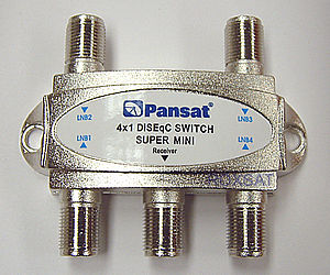

Hi I just got the full dish 500 setup. I used the satellite finder to make sure both outputs from lnb had signal strenth. then I put both coax to a pansat switch then to my receiver. When I do blind scan on both 119 and 110 i only get 119 channels??? Any help.thanks
Username: Shayeileen
Post Number: 141
here is the lnb i have and the switch if you need to know.....
Post Number: 142
got it....forgot to change diseq settings on receiver.....but thanks for all the posts...lol
Username: Prfrmnj
Post Number: 2254
Shay - That would be because you are not supposed to use a switch with that LNB. That is a DishPro Twin which already has a built in switch. Each output carries signal for both 110 & 119.

My Dish 500 (110 & 119) is connected 2 a diseq switch.
It looks just like urs. Everything works fine - but it is problematic.
To blind scan, i need 2 shut it off at the back before scanning each satellite - or else, for some reason, the channels get crossed over.
I also have 2 do a factory reset before the first blind scan. This is all because the Dish 500 is a pain.

Okay, Dish 500 is just the dish itself. DishPro Twin or Quad and DishProPlus Twin LNB's are something else. These LNB's are associated with the Dish500 dish because that is what they were designed for. But you can use single LNB's rather then the DishPro's.
Now, you do NOT need a switch (specially a DISEcQ) switch if you are running DishPro Twin/Quad or DishProPlus Twin LNB's.
You can NOT run TWO DishPro Twin/Quad or DishProPlus LNB because of the Internal Switch configuration.
What I mean is this switch is setup internally to receiver as follows:
119=1
110=2
91=1
82=2
This creates a problem when switching channels because you cannot have two. You can solve this by either using Single Dual output LNB and running them directly to a DISEcQ Switch.

Username: Prfrmnj
Post Number: 2288
Shane - You would not use a DISEcQ switch. You need to use either a DP34 or DPP44 switch depending on your lnb's. You'd have to use all DP lnb because you can't mix match lnbs and you con only use dishpro switches with dishpro lnbs.
