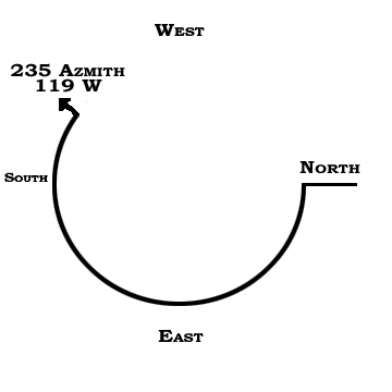

First thing you need to do is find a spot to bolt your 33" dish to 119W
- Newark is 25 degrees Elevation
- 235 degrees from north (you go clockwise)
- What brand is your dish and LNBs?

You say 235 degrees from north...is that with or without the correction? true or magnetic?

if due south of me is 75*43'
what compass degree do I point my dish to to find 119W from 39*40' ??

forget the motor direction for basic set-up start
- Find your true north (e.g. include Mag Dev)
- Go 235 deg clock-wise
- Set dish elevation to 25 deg
- After you get your first SAT then add motor

For EchoStar 7 at 119.oW 245 Degrees.

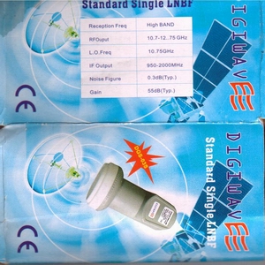

ok currently seeing scrambled channels (not really) called:
tv7210-11724vEc, tv7211-13, 16, 675, 705, 709-712, 728, 751 etc... Channels are also duplicated with Ga after them. (I ran another scan?)
I'm using this lnbf:Upload
I also have a DSS dual lnb somewhere....
