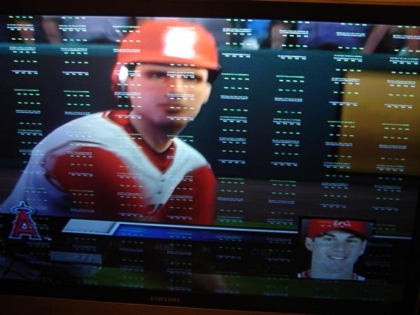

I have a HLN617W1X. About six weeks ago a series of vertical lines appeared in the picture. Then the picture went completely out. I replaced the bulb and presto - back to perfect. Then, that bulb blew after three weeks! I exchanged it from the service shop where purchased, and presto. Again a perfect picture. During the bulb change I also removed the rear panel and cleaned inside and fans as recommended.
The second new bulb has been in for about two weeks and the vertical lines just re-appeared yesterday. I am expecting that this bulb is going to go out also.
What would the underlying problem be for the lines appearing and the bulbs continuing to fail? I spoke with a tech by phone and he said the DMD board was bad.
After reading many of your posts FYI, I contacted Samsung and am in the process of getting a diagnostic done (scheduled by them) and I am going to push for a new board (politely but firmly!). Is there a difference between the DMD board and the analog/digital upgrade that I have read about.
Sorry for the length!!! Please help
Username: Fyi
Dallas, Texas
Post Number: 1049
Registered: May-05
The DMD is fine.
The digital board is the culprit.
It tells the DMD what to display.
The "N" and "P" models have had a few of these boards crapping out lately. Symptoms have included lines, freezing, negative image, fixed color, blackout, loss of control, and shut down. For a while techs were replacing them with boards that would eventually fail too. I see that samsungparts now shows a few models having an upgraded digital board. Only time will tell if they have corralled this issue.
Original owners with two or more repairs usually get options for a newer model replacement, if you press it. They usually hit'em up for shipping, though.
Best of luck with your situation.
Let us know how it turns out.

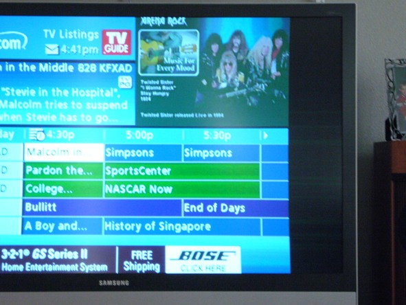

Username: Gortguy
I have an HLP5063W with the following problem:
http://img444.imageshack.us/img444/7333/img0584dy3oz9.jpg
It's much worse when the TV is first powered on; that picture is what I get after it's been on for an hour or so. Had a Samsung tech tell me the DMD board needs replacing, so I have two questions:
1.) Is replacing the DMD board a DIY project?
2.) Is it worth replacing or would it be better just to get a new set?
I hate to think my $2k "investment" in HD only lasted a couple of years (especially when my POS analog TV is 10 years old and going strong).

I have a samsung dlp HLR5668W and i'm experiencing a 3-4 inch darkened portion on the left hand side of the screen. Upload does anyone have any idea what the problem would be?
thanks

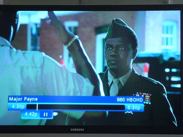

No one seems to have my problem. I have a 4663 that when you turn it on it clicks twice. Once in the ballast and once somewhere else. It does this three times while the lamp light blinks. Then all three lights come on and nothing else happens.The lamp never comes on,it is new. The fan is working.I can't tell if the color wheel is spinning.Any ideas?
Username: Sjones1
Post Number: 38
Bob,
It's very possible that the color wheel is stuck...and unable to spin, hence, the TV shuts itself off.
The color wheel has two connectors: 1 for power and the other one is a sensor that reports back to the bios of the TV. I would take out the color wheel and physically inspect it. There is a chance one of the colors might have chipped off.

Username: Bbs
Mukilteo, Wa Usa
Registered: Feb-08
Steve, I checked the color wheel. It appears fine. It spins freely and is intact.Both fans are on. When I turn it on I here a click, it is not the ballast as I thought but it comes from the board where the power chord comes in. After that I hear another click from the other side of the tv. Then the chimes go off and I hear a slight pop in the speakers.I think this is the power going thru the startup process.At this point the lamp light comes on and then it starts over again.This happens three times and then all three warning lights blink.The lamp does not fire at all. I still can't tell if the color wheel is turning. If it is not would that prevent the ballast from starting? I'm thinking it may be the board behind all the cable and video hook-ups. That's where I hear the second click and it almost sounds like a crackle as if it is stuggling to perform it's function. Does this make any sense?
Username: Sjones1
Post Number: 40
Bill,
This sounds like a problem that's frequently associated with RCA Scenium TVs, though I can't be certain because obviously I've not diagnosing it in person. In the case of the RCAS, it is a IC...and this IC controls the functionality of the color wheel. I wonder if this is your problem...it would be an interesting paralell..
I'm afraid it is going to be an expensive repair regardless :-( Keep us updated on what happens, but you definately need a local tech to diagnose it properly.

Got a Samsung HL-P5063W. The general picture and color seem fine. However the entire screen is covered in a repeating pattern of green and blue horizontal lines (See photo). Anyone have a good idea of which component is faulty?Upload

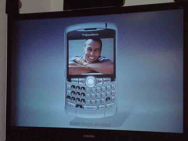

I have a 5 year old 50 inch Samsung DLP model HLN5065WX. For about 2 months now it has been showing hazy horizontal lines across the screen, sometimes very close together, sometimes more spread out. I have two satellite receivers and two DVD players connected to my TV, the problem exists when showing either of the receivers and one of the DVD players, the other DVD player shows a perfect picture.
When I display PIP, the second input is perfect but the first input retains this problem no matter what source is displayed.
I've replaced both the color wheel and the Lamp to no avail.
Any help or advice would be appreciated.

I have a Samsung HL-R5668W Big Screen (S/N ACAB3CKYAO(0?)1304E) that's had a problem for about 6 months. The left edge of the screen acts like the brightness is turned way down (see attached photo). Horizontal deflection? Blanking wandering into the picture information?
At first, it just appeared one day like you see it in the picture. It has been stable at about 2-3 inches into the picture until recently, but now it is extending further into the screen (about 6 inches).
Has anyone experienced this? If so, how did you repair it?
Thanks

Rob Day - that means that the light tunnel is "collapsing". Apparently they're not very well designed and this kind of thing happens. If you're still under warranty, get it checked out.
I posted on the other thread and I will here too - anyone who still has a good color wheel housing (housing ONLY), perhaps from buying a color wheel + housing from somewhere, I will buy it from you. Email me at auralis [at] fastmail (dot) com.

I have a Samsumg DLP HLR Series (not certain whether it is a 4667W, 5067W, 5667W or 6167W). If it matters, my lamp code is BP96-00823A(O).
My problem is that the TV has a green (and sometimes red thunder) discoloration, which is most noticeable on skin tones and light surfaces of the TV. The discoloration runs from about 2/3 of the way up all the way to the bottom of the screen and horizontally all the way across from left to right.
The TV does not otherwise make any strange noises or have any other problems.
Any suggestions? Thanks.
