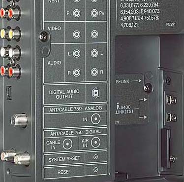

Thanks very much for the info. So if I had a DVD Recorder with a Cablecard slot of its own, an ATSC tuner, and firewire port, I could then hook it up to my tv and record one digital channel while watching another? I would need two Cablecards? Is Firewire the same as iLink? I have two of those ports on my Sharp 32-D7U. Sorry to be so dumb, but I have just begun to learn anything about these digital connections.Upload

The iLink port on your TV is a firewire port, also called IEEE-1394. That port is to send high bandwidth data (like HD video) from your TV tuner to an external device, like a DVR. However you would only need to use it if you were recording what the TV tuner is tuned to since the TV tuner is what determines the source of the data going to that port. In that configuration, you can only record what you are watching.
If you had a DVR with it's own cablecard and built in tuner (yes, you would then need 2 cablecards), then the DVR could record independently from the TV, just like how a VCR and TV work today. Then the DVR would only need a standard connection to the TV for playback, i.e. HDMI (digital) or Component.
