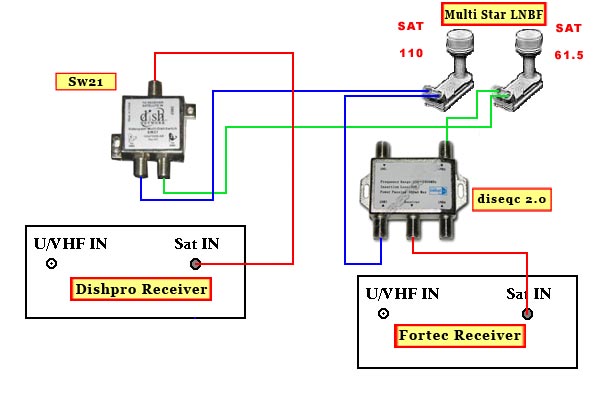

UploadHere is a chart,thats how is hooked up right now

Like I said before...IF this is all true, then U have either a bad cable and connection, or a bad disque switch, or a Fortec FTA receiver problem..

BTW...it would have been nice to provide that diagram set up initially, so I people wouldn't have to ask, as I had to, about everything...it would have saved me alot of time..ALWAYS provide as much info as possible when seeking help..especially with a BUMP!

Username: Babakhan
Post Number: 85
Thanks Lk...yeah i have seen so many stupid que here.. with no information..anyways so i made this diagram to help other ppl as well
