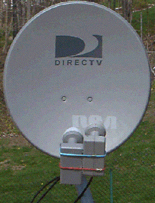

New member Username: Gandalf1Post Number: 4 Registered: Nov-05 | Thanks h3lt3r_sk3lt3r and satlover... I found this pic in the archives... looks like I have a lot more reading to do.. but this gives me an idea... its the same dish I use so I figure all I need is an extra LNB mounted like this to get me started...![]() |
New member Username: Gandalf1Post Number: 5 Registered: Nov-05 | The only thing I don't understand is... looking up the elevation and azimuth, I find they are different for 110 and 119.. so will I need to re-align the dish everytime I want to go from 110 channels to 119 channels? |
Silver Member Username: SpankPost Number: 224 Registered: Oct-05 | No, you just need to align the 2nd LNB properly and you will have both at the same time. Notice in the picture the way they are sitting one above the other. It takes a couple minutes of tweaking the dish and the LNBs and you'll have it. |
satlover Unregistered guest | NO you don't need to turn your dish. After you gott 119, just put the other lnb next to it and you should get 110. With the above picture, 119 on the right, 110 on the left (from westcoast). |
Anonymous | You mean it should get 119 first then 110? |
Anonymous | If I already got 110, should I turn the dish to get 119 first? |
Silver Member Username: H3lt3r_sk3lt3rPost Number: 535 Registered: Oct-05 | Usually you align the dish to 110, and then it's easier to adjust the lnb to 119, because 110 has a stronger signal. |
