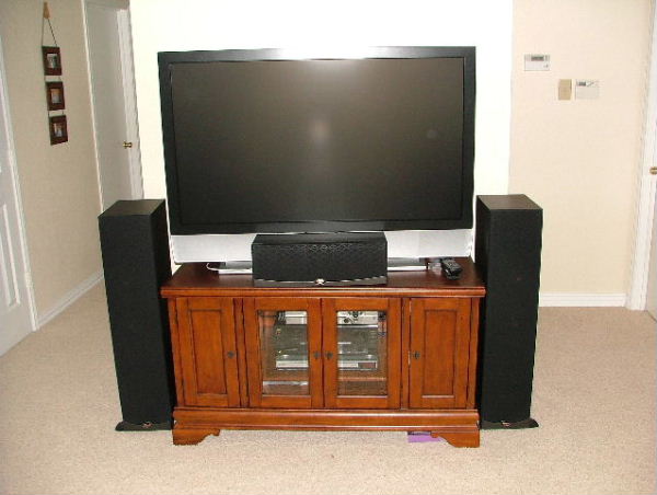

Here's mine.
My stand is 28" tall & consider it a perfect hieght, got it at Costco for 289.99.
I sit 12 feet away from the TV & it looks near perfect with SD.

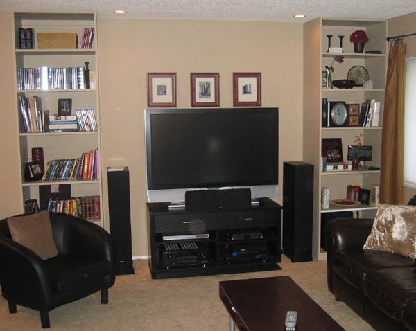

Here's my stand. I was going to build one, but BB had a nice stand that the wife liked. It was $200 and he gave it to us for $100. Can't argue with that.

Dan Furlong,
It appears we have very similar taste in electronics. It looks like your running Klipsch RF-25's and a RC-25 center speaker... am I right. That's what I have. I use Klipsch RX-4's for my rears and power this setup with the H/K AVR330 receiver. What brand receiver do you have, and do you like the way it sounds with your Klipsch speakers? I also have a 28" stand, but it seems a bit too high to me. But then, it all depends on the couch that you have I suppose.
Very nice pics everyone!!
