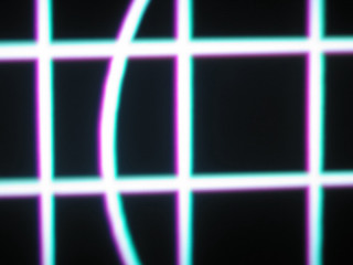

There are some problems with it that concern me such as fringing/chroma aberration, geometry/pincushion problems, green tint, grayscale, short bulb life, uneven coloration across the screen, etc...

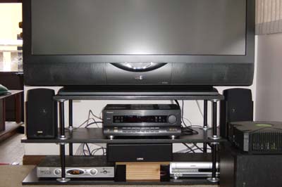

Put together a stand for my (our) new JVC. Used MDF and pipes.
Figured I'd post a picture if anyone is interested.
Still have to hide wires and figure out the center speaker placement.

Dave-
Very cool. I like seeing the home made stands. My friends setup is very similar and he ran a thicker painted PVC pipe up the back for the wires.
I'd try to get the center channel on the same plain as the left and right speakers. Maybe stack the cable box and the DVD/VHS, and move the receiver down next to them. That would leave the the old reciever spot for the center channel. Just an idea though. Nice work!!!

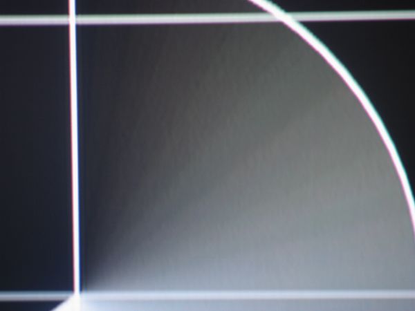

JVC has asked me to take digital pics of the "green" and misalignment that I'm talking about. I'll post when I get them.

Yea .. but this seems to be something different. For instance .. using the DVE disk .. when you have the sync images (sweeping clocks of different colors ending in a "beep") .. in the grey clock the low dark or begining of the sweep is greenish.
Also when looking at the white alignment grid, I can definitely see green on one side and sometimes red on either side of the white lines .. sometimes as much as 1 full pixel width.. especially away from the center of the screen.

"Also when looking at the white alignment grid, I can definitely see green on one side and sometimes red on either side of the white lines .. sometimes as much as 1 full pixel width.. especially away from the center of the screen."
I don't think it can be fixed. I can see the same thing, but only when I have my face a few inches from the screen. This pic is from MNF. You can see green on the left of white lines, and red on the right. When I get atleast a foot away from the set it no longer becomes visible. Where are you sitting when you see it?

A few inchs from the screen ... but my current theory is that this misalignment is what what is causing the green tinting in the grey scenes. Especially grey scenes with motion.
The problem is separating the DVD scaling errors from the TV errors. I wish that the HD sources (cable/sat) would provide test patterns someplace. I'm surprised and disappointed that the cable boxes or TV's don't have them built in.

That looks like the chromatic aberration I'm so worried about. That's one of the things pushing me towards the panasonic DLP set at the moment.

>> my green screen
OK, JVC asked me to take some pics and e-mail them which I did on my wife's new Canon 7.1mp S70. I reduced the images to 320x240 so here there are.
Pic#1 is a closeup of Morpheus .. see the greenish tint? (702p HD Comcast Source via component)
Pic#2 is of a football coach ... see the tendency to green on his shoulder in the bright white? (same source)
Pic#3 is a closeup of a white grid test pattern from the DVE disk .. which should be a several white pixels wide. See the green/red edges (DVD source at 480p via component).
Pic#4 is a a veru closeup of the grey sweep/beep pattern ... see the greenish tinted bands in the dark areas

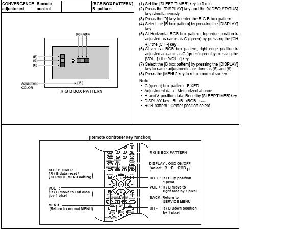

Mark, I am under the impression there is no 'convergence' on these sets as the lenses are fixed to their position permanently.

You can adjust the convergence on the JVC. It is fairly simple to do and it covered in the Service Manual. All you need is the remote.

Thankyou. I'll check this out. I have the service manual (thanks to you) but don't want to mess with it till after the technician has been out. Have you ever experienced what I like to call "Green Teeth'? Let's see if that catches on! ; - )

>> Getting within a few inches I can pick out lots of flaws, but then the TV wasn't designed to be viewed that close.
I wouldn't be complaining if I didn't see the green tendency in the images consistantly. The nose to the screen was only an attempt to discover clues to what may be at the heart of the larger issue.
JVC now has the full res versions of those screen shots and I am awaiting their feedback.
Ang

Looking though the service manual I notice that only the red and the blue are adjustable. Hopefully something can be done to correct the green issue. If anyone one gets an answer it would be great to hear.

Username: Angelog
Post Number: 80
Registered: Nov-04
Mr. L,
>> My post wasn't directed at you guys,
No problemo. I think the most telling image is the gray sweep-beep pattern. You can clearly see banding in the lower grey scale, but also the greenish tint on only sertain grey levels. Also notice that the brightness on the edges of those gray levels are higher, making the banding effect worse. I guess this could be due to a misalignment or possibly that the green has a different lumanance curve than the other colors that isn't getting properly compensated for. Or this could be from the DVD decoding.

I can see the banding in your pic. Is that test pattern from DVE?
Yes .. some of the patterns way in the back of the DVD. You can not only see that the lumanence ramp isn't smooth but also at certain discreet values, green pushes thru.
Again .. there is no way to distinguish this from the DVD player or TV. What I'm showing is from the DVD at 480p and using the JVC scaler .. so I'd hope that'd minimize the DVD's influence.

I messed around in the service menu tonight. It was very simple to correct a slight convergence problem I had, and I also moved the whole picture over 2 pixels so it is dead center now.
When you enter the service menu, hit the sleep timer then press "display" and "video status" before the video timer info disappears.
DVE has some great test patterns you can use to adjust the centering and check the convergence. You can go in, mess around and exit without messing anything up. It will only save the settings if you press the "mute" button. If you don't hit mute after adjusting, the values will reset when you turn the TV off.

Username: Ahseng
Bay Area, CA USA
Registered: Jan-05
Mr. Lynch,
This helps. I am now able to get to the RGB pattern box. My problem was I did not hit the menu key first. Thanks.

Hey,
Had a service person come out on Tuesday and hook up a pattern generator to my JVC (in response to my green teeth issue). I sat there with him and tried to point out the excessive green but couldn't really find it in the test patterns he proiduced. He said everything looked exactly as it should and I couldn't prove him wrong. I could not reproduce the problems I was seeing.
He suggested the TV may have to run for awhile before we saw it. I guess I'll attempt to 'tune' it out as best I can. What frustrated me is he said he consulted with a JVC rep and they agreed that it was impossible for the TV to be adding too much green to the picture. That's horse pucky! There are three different chips. Why couldn't one be overstating it's portion of the picture?
Well, bottom line I'm going to get a DVE and tune it myself. Can anybody suggest a good place to pick up a DVE or Avia? Is one better than the other?
Mark

Username: Angelog
Post Number: 84
Registered: Nov-04
Mark,
You are absolutely right and you can see that in the picture I posted. Service tech's, cable guys, etc .. they are used to dealing with a public that doens't have a clue and can quickly move to Know-it-all mode. The problem is that some aren't able to deal with a knowledgable customer.
Ang
