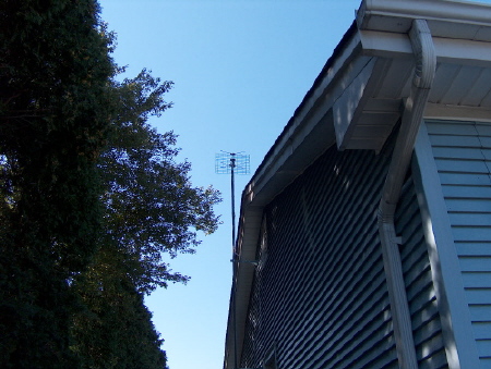

I have a UHF multi-directional (the DB2) sold by antennasdirect.com, for $39, and it is great. It is somewhat directional, but will pull in stations from all directions, and has a high gain of 11.4 dB with no amplification. I am pulling in 6 HD stations that are 40 miles away, and I'm recieving a signal strength of 7-8 on those stations. My TV rates signal strength 0-10, so I believe this antenna should be good up to around 60 miles. The next model up, the DB4 for $59, probably to 100 miles.
Radio Shack sells a "combiner" which is similar to a splitter, but which supposedly works in reverse. I might give one of those a try. Hope this helps.

I'm hoping someone can help me improve my over-the-air HD signal before the SuperBowl. I have DirecTV, they installed an antenna for local channels. But my reception is spotty for some networks (ABC), non-existent for others (CBS).
Antennaweb says I'm about 24-27 miles from the broadcast sources. I'm north of Atlanta, so terrain can be a little hilly.
I just tried a small in-line Terk amplifier, thinking it might be a simple, fast solution. It made things worse. I couldn't get ANY signal with the amplifier. ABC was coming in OK without the amp, not at all with the amp.
Could the coax cable I'm using be the problem? I connected the DirecTV antenna coax to the Terk, and a short, generic length of coax to connect the Terk to my HD receiver.
Or could it be that DirecTV's antenna is low quality?
Is there a simple way to improve my signal? If I can avoid climbing high on my roof to install a new antenna, that would be my preference.

if the DirectTV antenna is the type that clips on to the dish, it is very low gain and used for local 5-10 mile signals only. You need a directional UHF antenna pointed at the broadcast tower you want to receive. Read my post just prior to yours. Bring the feed from the UHF antenna directly into your Direct box and connect to the over the air (antenna in) connector, not the satelite in connector.
In your existing set up, the Direct local antenna is mixed with the satelite signal and then split back out at the Direct box. your Terk amp will not work in this situation.
All this assumes you have a ATSC digital tuner either in your TV or in your DirectTV box.

I am connected to the Antenna-In. I do believe I have a directional antenna. It's not the type that fits over the dish, but a long wing-like unit pointed in the general direction of the signals (South). As I said, I am receiving some channels, but not reliably.
I have a feeling that if I could extend the antenna higher, I'd get better reception, but that seems like it would be a difficult solution.
So, the easiest solution I can think of is to try to amplify the signal I'm getting. But the $20 Terk in-line amp didn't work. I'll try to find a better amplifier.
Maybe your solution of a second antenna and combined feed will work. I'll try an indoor antenna. What are you using to combine the 2 feeds?

unless the amp is the type that mounts right at the antenna (or extremely close), with the power input from inside the house - you won't see much difference. That is also why the over-the-air feed coax needs to be completely separate from the satelite feeds. The DirectTV box actually puts a certain voltage in the coax to power the low noise amplifier mounted at the dish feed point. Anything else mounted in-line will conflict with that.
Your initial guess is the best.....get the existing antenna higher in the air, even if it is only a temporary "lash-up" to get you through Sunday. You will be out the cost of some new 75 ohm coax feedline - do not try to use the existing DirectTV lines. Everytime you add a splice or connector or splitter, etc. you lose a considerable amount of signal strength through losses, plus the signal lost in a long coax run. What they don't tell you is that an in-line amplifier is really used to overcome signal loss in all the coax and connections (which can be considerable).

I'm going to try the second antenna, combined feed approach, because it seems the easiest. Getting 25 feet up a ladder, running new coax, etc. is more trouble than I'm willing to deal with right now. And it sounds like an amplifier isn't going to help, either.
