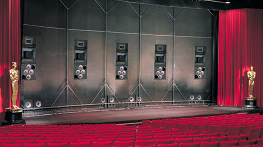

Gold Member Username: Thx_3417Bournemouth,... Post Number: 1644 Registered: May-05 | Sub bass speakers go at the front, nearly all the top professional THX cinemas and nearly all the sub standard cinemas worldwide have all the sub bass speakers placed at the front, the sound will radiate outwards into the room, so don't waste your time with placing them all over the room, up front is where they rightfully belong! ![]() |
Gold Member Username: Thx_3417Bournemouth,... Post Number: 1645 Registered: May-05 | Also I would personally recommend an 18" JBL 4645C sub bass, two would be most suited for this size room and they will truly give you true cinema low end without the compromise, if you look around first before committing yourself to the project, you might find yourself saving some of the projects budget costs, there are plenty of professional cinema installers throughout the USA and if you look and I mean look real hard you'll find the best deals. The JBL 4645-C will require it's own amplifier and active X over and like I said if you really look around, given the cost now might slightly go over the estimated budget, the JBL will leave the others crawling in the dust! ![]() |
