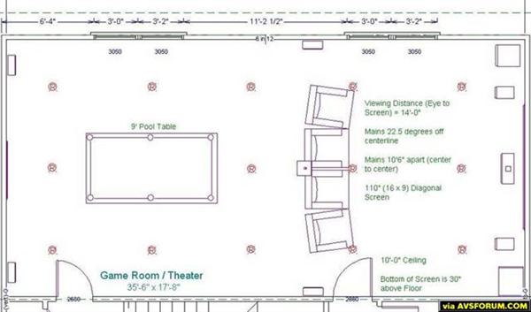

Bronze Member Username: Noya83Portland, Oregon USA Post Number: 19 Registered: May-06 | Here are a couple of pics of the Boston amp reviewers theater/game room. Notice his room is 35'x17'= 595 sq ft, similar in size to yours. |
