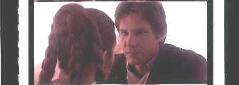

Enter "SDDS 8" now this is a multi-channel format with five full range channels placed behind the screen and two split-stereo surrounds and one LFE sub bass track the encoding is placed on both sides of the 35mm film on the outsides, all these need special modified video cameras that bounce a beam of light onto the film and is picked up by the video camera and goes to the decoder for translation and the final process is magic, we now have multi-channel sound, and unlike the Todd-Ao era which came up with the 70mm six-track magnetic process multi-channel as been around for a long, long time with fantasia in the late 1940's.

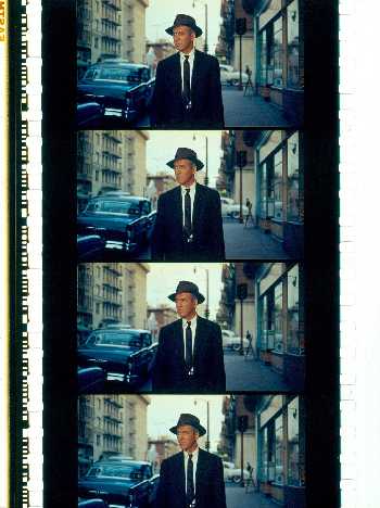

Also there is dts 70mm which is a great format not much around any more, but some cinemas still playing this format at special 70mm events.
