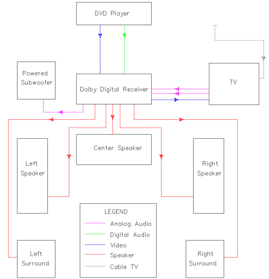

I think that this image is a good display of my setup: https://www.ecoustics.com/electronics/forum/home-theater/113705.jpg except I also have a VCR between the cable and TV (with lines running from the VCR to the receiver as well. So I feel like this reassures me that I have done the cabling properly.
Any further suggestiosn?
