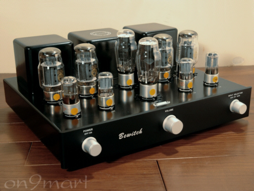

Username: Exerciseguy
Brooklyn, NY United States
Post Number: 2528
Registered: Oct-04
Any opinions? This amp seems to pack a lot of goods into a nice tidy package.
http://www.acoustic-dimension.com/pure%20sound/pure-sound-A30-integrated-amplifier.htm
http://cgi.ebay.com/Bewitch-6550-KT88-Russian-Tube-Integrated-Amplifier
Yeah, yeah, I know it's Chinese Gray-market, I don't think I'm buying, just looking.

Registered: Dec-04
AUDIO Pradikat:
überragend, 100 Punkte, High End Klasse, 5 Ohren.
"Prachtvoll aufgebaut und bestückt, extrem feinsinniger, farbenreicher Klang"
What more could I add?
If there is warranty support, and the Alps and other parts are genuine, then this unit deserves a shot.
Post Number: 2529
Registered: Oct-04
How did you pick up your Yaqin?
Post Number: 2530
Registered: Oct-04
Just looking Art, this seems like a reasonably good deal, if all holds true.
The Pure Sound A30/Bewitched 6550 seem to be more widely available in the UK.

These Bewitch valve amps are often on Ebay here in Aus Chris. I read on a forum here sometime back that the buyer was very happy with his purchase and that it was well worth the money. The Yaquin seem very good value also.

Yeah there are plenty of options out there, this Pure Sound/Bewitched just seemed to jump off the page at me as a good deal.
Buyers seemed to be pretty satisfied.

CM, I would check into the guts of the amp a little bit, as I did not find much info other than the glossy 1/2 page reviews. From what I saw, it seems like a good unit, but....caveat emptor. In that price range, I would look for soft start, point-to-point wiring, WBT, etc. That's why I sort of landed on the PrimaLuna. There's a Prologue One on A'gon for under a grand, and a recent one listed (SOLD) for $725. 35 wpc, EL34 output tubes, high quality build, seems like a fabulous amp for the money. No phono stage, but I don't believe the Bewitched has one either?? Just an opinion. Cheers.
