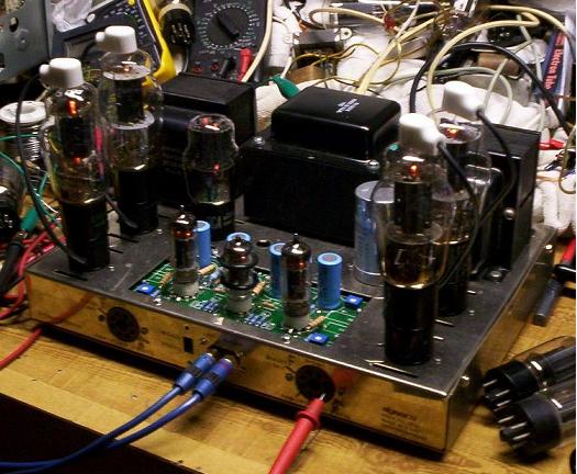

Actually lower gain in a stage be it tubes or anything else can and usually does
make for lower noise and a cleaner signal. As any amplifying device has a power
supply amung other things introducing grunge into the signal path which can be
quite a bit and very noisy not to mention the device it'self like a tube just sitting
there and running full boar without even having signal present has noise it'self so
a lower gain device it'self "can" be quieter then a higher gain one for sure.
Now once a signal is present the signal it'self boosted by the amplifying device
may or may not be quieter and cleaner depending on how quiet and clean they
are compaired to each other with no signal. But by lowering the noise floor in a
piece to start with (possably with a lower gain tube) should give you the cleaner
signal in the end.
In otherwords the math tells you a lower gain device is quieter when no signal is
present, but if the inherint device is noisier to start with than the higher gain device
it may be a wash or even worse. I generally believe 5751's are quieter then 12ax7's
as an amplifiying device then you add the slightly lower gain usually spells a much
quiter signal all the way around. Quiet passages in music are quieter, backgrounds
are blacker then any difference in sonic signature can take over as well.
The gain difference between the 2 is usually pretty small in any given piece, but as
Jan said another benefit to this (if your piece still has sufficiant gain) is you can turn
the pot up higher while getting the same volume as before to where now the previous
piece "can" see a better load to run into.
As I siad it's not allways an "upgrade" to run a 5751 instead of a 12ax7 but the chances
for success I believe are quite high. But it also comes down to how much and in what way
the change may have affected the tone of the piece as well. I believe all the way around a
5751 is a better "sounding" tube then a 12ax7 but in some circumstances it won't be.
Some may still prefer the sound of a 12ax7 over a 5751 if they like the sound they produce
in the first place, I happen to prefer the 5751 and think it sounds better.

Worth the time and money switching out the driver stage (12at7) tubes in the Jolida?
Heard that was waste of time and concentrate on preamp stage. I currently have the ecc81 JJ tesla version in there now.
Just seeing that NOS 12at7's are a steal when compared to the ax7 versions.
Any thoughts?

I hate to sound like a broken record, but if you do some good searching you'll see many
feel the 12at7 isn't that great of a tube either and I feel pretty much the same way. A lot
of times I'll sub a 6829, e180cc or 5965 in there place with very good results. Most these
tubes go for peanuts as there no longer made and no one builds any new equipment that
is based on a roughly 45 gain tube with the same pinout as the 12at7,12au7,12ax7 I use
them in some of my builds be it rebuilds or new creations, I find these great tubes for the
money and feel very glad most either don't know about them or just pass um up for there
usual suspects and pay more doing so. :-)
Generally the first tube "can" have a more profound effect on the sound/performance of a
piece then the rest of them will, but all the tubes do make up the sound of a piece so yah
other tubes besides the driver may make a pretty nice difference, won't know till yu try um.

5965a would be a safe choice for the driver stage on the Jolida in your opinion Keg?
Here is one for cheap.
http://store.triodestore.com/5965age.html
Username: Kegger
Warren, MICHIGAN
Post Number: 2763
Registered: Dec-03
Yes I believe that tube should sub in just fine on your amp.
Only issue I've had with the 3 previous 45mu/gain tubes mentioned are
microphonics, it hasn't been an incurable one with good isolation though.

Ok, now I am really confused. I have been playing the new 5965a's in the driver stage of the Jolida this morning and love the sound. I now have 5751 for pre amp and 5965 for driver stage for the front end on this amp. No one but Keg has given me suggestions on substituting tubes for the ones supposedly needed for the amp. This amp now has much more detail and strength especially in the midrange and such a difference in soundstage(seems wider and deeper). Why would the tube shops not suggest this type of swap if it sounds this much better. I am not kidding when I say that the combination of these two substitutes make a big noticeable difference. Is it because they don't make any money off of these tube types? Oh well. thanks Keg and I really hope someone else can try this kind of swap soon.
For the record, total spent $52 for the four tubes and $14 for shipping (since it was two sep orders) not bad.

One of my long time creations is finally taking shape.
It's 6BG6G tv sweep tubes utilizing adaptors I built to fit a standard socket.
Right now it's in experimental stage but running well, I'm testing on st-70
output trannies but the final build will be Acrosound TO-300 outputs which
are a very nice impeadance match for these tubes.
These are 19watt plate tubes so they should work well with the Acro 35w OT.
I will also be experimenting with the 35watt plate versions on a 60w Edcore OT.
So far I like what I'm hearing and my front end board is holding up rather well. :-)
OH yah this 70 has the new triode electronics beefier power trannie as well.
Not needed with these tubes but I now can run kt88 and or kt90's in this amp.Upload
Username: Nuck
Post Number: 6111
Registered: Dec-04
Kegger, good to see you again.
What final output would you expect with 88's or 90's, seeing as you have the power transmission in place?
Clean your bench, man, make room for a beer can or something.

Username: Kegger
Warren, MICHIGAN
Post Number: 2770
Registered: Dec-03
On an original 70 the power trannie is the limiting factor without it bursting
to yeild about the 40wpc rated, on one with the new power trannie 2 things
become the limiting factor and that's the ouput trannies and the single 5ar4
rectifier to the tune of say 55wpc if your really pusing it.
The outputs the farther you push them the less bandwidth you can yield from
them, a 5ar4 rectifier is good for 250ma of current it can provide.
So you need beefier outputs and either solid state rectification, dual rectifiers
or a pair of high output tube damper diodes which you could use with this new
power trannie and remove the original can cap, install another socket and and
go dual rectifier or dual dampers. But really by then you might as well build a
new amp and do it right with more room and a better power supply.
I have a plan for the future of building a bigger amp with larger outputs and the
beefed up power supply on a larger chassis, but the 70's are about done here.
