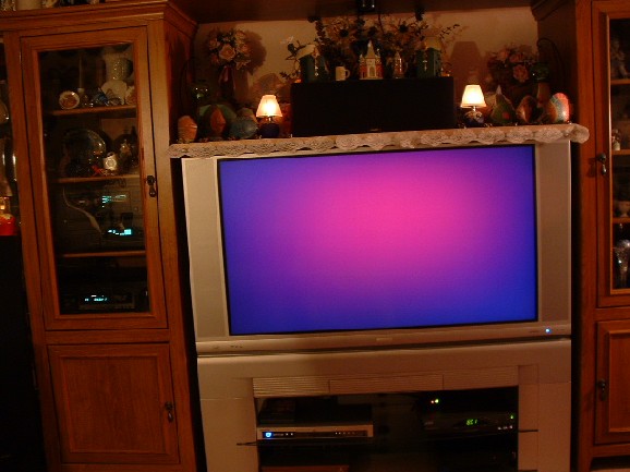

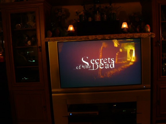

New member Username: Tv_mikePost Number: 7 Registered: Oct-05 | Here's another example of the bloom. I have a service tech coming to look at it tomorrow, but it looks like I already know what the answer will be. Here are two pictures that show what I'm talking about. The first is a shot of the TV set to an unused Video input. The blue is a little exagerated because of the extended exposure time but you can clearly see the redish bloom I'm talking about. The second shows the same area affecting the picture. ![]() ![]() |
Silver Member Username: John_sColumbus, Ohio US Post Number: 491 Registered: Feb-04 | Michael, Good luck with that service call, and please let us know how it turns out. I do have a couple questions for you: How many hours is on the set? Do you have enough ventilation room in back of the TV? (The exhaust port is directly in back.) |
New member Username: Tv_mikePost Number: 8 Registered: Oct-05 | John, Thanks for the response. The TV is about a foot off the wall so I believe that ventilation is adquate. The TV has 4486 hours. I just received a call from the technician. He had the following questions. 1) How big is the spot? 2) Are there stripes? 3) Does anybody smoke in the house? I told him that the spot was a couple of feet big and appeared to be growing very slowly over time and that there were no stripes. The picture was viewable and nobody smokes in the house. He paused for a couple of seconds and said that he guessed he needed to come out and look at it. I'll show him this site as well when he gets here. I plan on posting the results of his visit as soon as he's done. |
New member Username: Tv_mikePost Number: 9 Registered: Oct-05 | Well, the service guy has come and gone...WITH MY TV!! Apparently he had no idea what the problem was. He thought maybe someone was smoking in the house and that was making the optics dirty. I told him that I been looking into it on the web and that in most cases the light engine needed to be replaced. He didn't do a thing!! Just looked at the picture and said "I see what you mean" and that it would need to go to the shop if I wanted it fixed. They will determine what is wrong with it there and then order the appropriate parts. I should have it back in 7 to 10 business days. What happened to troubleshooting? I don't think this guy would have been able to do anything I couldn't have done myself. This was a very frustrating experience. What's most frustrating about this is that the TV was watchable. Now I have nothing! I called PC Richard and they said that they could not understand why I was upset that they couldn't fix the TV at my house. "We can only do the job right at our shop. And you do want us to do it right. Right Mr. Somers?" AHHHHHHH!! I just hope they can have it back to me before next weekend. |

Bronze Member Username: Tv_mikePost Number: 12 Registered: Oct-05 | I just got off the phone with P.C. Richard's repair department. All they were able to tell me at this point is that they have ordered the parts. They couldn't tell me what was ordered. Next I asked if I would get a report of what was done. I was told that they usually do not provide that for a warranty service but I could request that it be provided when I arrange for the TV to be returned. In the meantime, it will be 3-7 business days before they get the mystery part. Looks like another weekend of small screen football. Stay tuned... |
New member Username: ScoobyhitshardWaco, TX United States Post Number: 2 Registered: Oct-05 | Mike, I got your message regarding the linking of your post to this one. I have a link to where you can get the service manual. I tried what Danny at the top of this page said worked for him. Unfortunately my settings were already defaulted to what repaired his TV. I'm usure if I can post likes so just send me an e-mail and I'll give it to you. It's a 2MB PDF, very confusing, might as well be in Greek. BTW some jerks are selling this same service manual for about $10 on ebay. |
Bronze Member Username: Tv_mikePost Number: 14 Registered: Oct-05 | Alex, I went to the eserviceinfo.com site and downloaded the manual yesterday. It was less than intuitive but I was able to get the full manual (193 pages). For anyone else who is interested, here is the link. http://www.eserviceinfo.com/index.php?what=search2&searchstring=50V500 There are 2 differnt documents here. The first, "50V500.part14.rar" is the 193 page Service manual. The second, "50V500A.part2.rar" is a parts list addendum. These files are compressed using WinRAR. This is similar to WinZip but has better compression ability. It can be downloaded for free from www.rarlab.com. To get the manual; 1) Create a directory to save the multiple files to. The manual is in 14 parts. 2) Save each file to the new directory. (You will need to save them all before you can open the files) 3) Once you have downloaded all 14 parts, open one of the files with WinRAR. 4) Double Click on the PDF file. 5) WinRAR will automatically open up all the other parts and combine them to make the complete manual. 6) Save the open PDF as a new file to a different directory on your computer. You should now have the complete manual. The same steps apply for the parts list addendum. |
Bronze Member Username: Tv_mikePost Number: 15 Registered: Oct-05 | By the way...After looking at the service manual instructions for removing the light engine (P.W.B. Assembly), I understand why they didn't want to do this at my home. |

Bronze Member Username: Tv_mikePost Number: 16 Registered: Oct-05 | Well, I called the service department for a status update and they are still waiting on parts. I did find out that the part that is on order is part number UX22202. This is the light or optical engine. Here is a picture from the web. ![]() P.C. Richard still does not know when the part will be in. 7-10 business days from 10/31 is the standard answer. So maybe I'll have the TV back by the 18th? We'll see. |

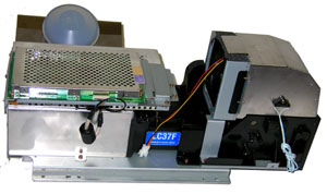

Unregistered guest | Thanks both John & Michael for the reply. Michael, looking at the picture of your pink cloud that is exactly what I now have except it is not as extreme yet. I did not buy the extended warranty and I am about 2 months out of one year so I guess I looking at having to foot the bill unless someone can come up with an answer before it gets too bad. It's kind of disappointing that it appears to be a very common issue with the sets. It don't expect a company to stand behind what they make forever, but when there is an obvious defect in the design I think they should at least make it as painless as possible. From what I have seen Hitachi does not respond at all. Anyone have an idea what this is probably going to cost? |
Bronze Member Username: Tv_mikePost Number: 18 Registered: Oct-05 | Steve, I looked up the part number for the engine on-line and $1800 seems to be the going rate. Since I purchased the extended warranty with PC Richard, I have not been working with the Hitachi Tech Support group. In your situation, I would start with them and post their response here. The other thing we could all do is post the following information from our sets; Serial Number- Date of Purchase- Hours of run time- Problem Decription- (Should be one Line) With this information up in one location, you and anyone else would have some ammunition to work with when calling Tech Support. It would be harder for them to dismiss your problem as a one off when you can list a bunch of other units by serial number that have had the same issue. With your set being 2 months out of warranty, they will certainly try to have you foot the bill. But, in my opinion, you have a valid claim to having this done under warranty. The warranty date is not a hard "go/no go" date. If you are persistent, I believe you can get them to cover it. By the way, if you don't have it yet the Phone number for Hitachi Tech Support is; 1-800-448-2244 Then Press; 1= TVs then 5= Speak to Service Rep. (It will ring) Then 2= Projection/LCD TVs If you can, Have the information I listed above ready. I will post my information later today. I just need to get my serial number. |
Unregistered guest | thanks Michael - I'll do that when I get home. I did call Hitachi service when I first got the red all over hue problem that I fixed through the service menu. All they would say is "you'll have to call a service tech" - I was persistant because I had read enough about the problem at the time to know it was common, and it would have been easy enough for them to give me the easy fix, but no luck. I called 2 different "authorized" service companies to start. The first said their tech was sick and it would be 2 weeks before they could schedule me - the service call would be $120 to diagnosis the problem. The 2nd said $60 for the service call, but they would have to take the TV to fix the problem. Luckly I kept looking around and found the fix myself. I don't mind paying for service, but I like to know I really need it.... |
Bronze Member Username: Tv_mikePost Number: 19 Registered: Oct-05 | Problem Descrition---- Serial Number- V4A013206 Date of Purchase- April 2004 from P.C Richard Hours of run time- Aprox. 4000 when I noticed problem. Problem Decription- Pinkish Bloom or Cloud visible during dark scenes or when screen is blank. Solution- Service is replacing the light engine. |
