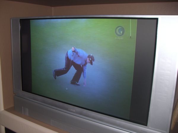

I have an update on my problem with the pinkish hue, it turns out that it was not the light engine problem. It was a EEPROM that holds the factory default settings that went bad. The service center replaced the EEPROM reprogrammed and checked out, it works great back to normal!!!!!!
Username: Rushfan2112
Hello all in the blue/pink blob group,
First, I want to thank everybody for all of the suggestions given and comments allowing me to feel that at least I'm not alone in this battle. Second, congrats to everyone that has been able to get Hitachi to fork over a new LE for you, I think that's great!
I'm having the same problem as the rest of you. I bought my 50V500 in June 2004 and it has around 7500 hours on it and now it looks like this:
You can't see the pink blob in the middle too well because the blue blobs are overpowering it. I've emailed and spoken to 2 different Hitachi CSRs and I keep getting the same thing that there's nothing they can do about it. Extremely irritated with Hitachi and their crappy customer service and not being the type of person that wants to be a complete jerk in order to get a company to fix a major flaw in their own design, I've been doing some research on doing it myself. I was able to find a copy of the service manual here: www.ued.net for $612.34 with a $200 refund for sending back your old part making it $412.34 to fix it myself. I've also deleted all but the last 14 pages of the service manual and posted it here for anybody who is in the same boat as me and can't get Hitachi to do the right thing, but still want to keep your 50V500: http://www.eserviceinfo.com/downloadsm/29684/Hitachi_50V500.html
I'm actually still in the phase of deciding whether to fix the TV myself, which honestly isn't that hard, it's just a little intimidating at first, or to say screw Hitachi and get a new LCD all together.
I hope this might help some people reading this post and getting to the very bottom of it.

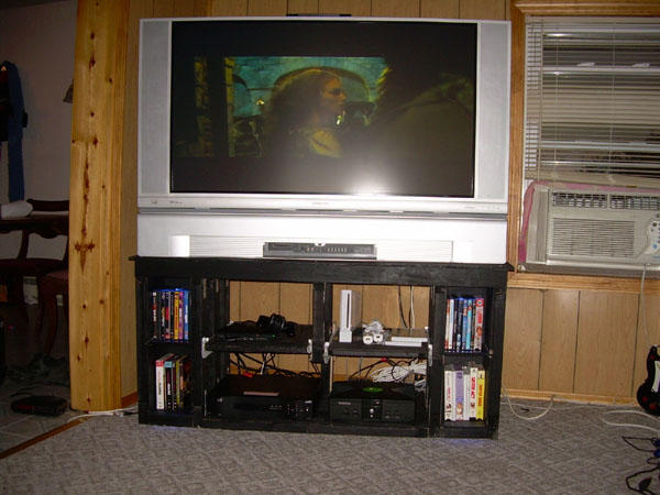

Here's some pics of the set on the stand I built for it. Upload
