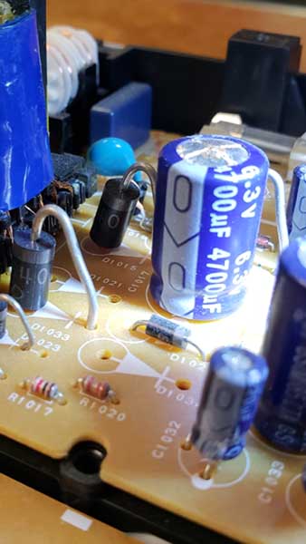

Yes I remember it was suggested to replace all the capacitors on that board but I only replaced one. As the video showed, one way to tell if a capacitor is bad is to look at its top; if its top is no longer flat but bulged or rounded up then it is probably faulty. I think there were three but I found only one with its top rounded and I only replaced that one. It's up to you about how many you want to replace.
The power supply board in lower down and yes you have to be careful removing the board(s) and you will have to remove the power supply board to repair it. Be sure to note how you took things out so you can replace the parts and reattach the wiring.
The capacitors are marked on the side. They have a specific range of voltage, capacitance, heat and you also have to get the right physical size so it with fit correctly on the board. I used a 4700uF 6.3V 12.5x20mm NCC SMQ 6.3V4700uF Aluminum Electrolytic Capacitor.

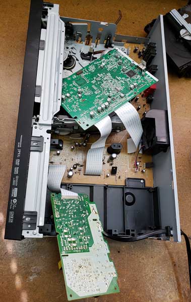

What is that top board that has the four cables on it?
Will it be sufficient to just unplug the two wide cables? (the ones the two red arrows point to)
Would it be better to unplug the two smaller cables on the other side?
How big a deal is it to remove the DVD unit? I assume it has to come out in order to get to the power supply.
I used to go to Radio Shack for these kinds of parts (capacitors, etc.). I wonder who, in the Atlanta area, carries this stuff now?
Thanks for the help.
Bob

I got one of the connectors to let go of the ribbon cable, but I am afraid to pry too hard on any of the other three. Do they come apart the same way?

I am at a standstill until I figure out how to undo those three black ribbon cable connectors.
Username: 2wonder
Post Number: 7
Registered: Oct-17
I don't remember how they came out, but I got them out and back in. I think I may have used a needle nose pliers near to the connector and carefully wiggled the ribbon a little side to side as I pulled on the ribbon with the pliers.

I took the cover off of my unit and was able to pull those ribbon cables out by hand. I found no hold down tabs or flaps on the connectors for those ribbon cables. Again, I just carefully, gently pulled the ribbon and it slide out!!!

I did an exhaustive search on youtube for videos on ribbon connectors. I found several, including those you listed. Thanks for doing that research, but I saw no videos covering the flipless connectors on this power supply board.
I'll try just pulling them out, like you said.
Username: Gyrobob
Post Number: 9
Registered: Oct-18
I pulled on the small one. It slipped out just like you said. The end of the ribbon cable is thick and stiff, so it ought to push back in okay. I wish I would have known this last week, eh?

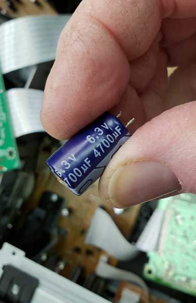

I got the top board out. I got the dvd player/recorder out. It was rather obvious which capacitor is bad. 6.3v 4700uf. The top is swollen and has brown stuff leaking out the top. See the pics.
I desoldered it and removed it from the board. No one locally carries that capacitor. Amazon will have one here in a couple days for a couple bucks.

Didn't work. The replacement of the capacitor was simple, but either it is a dud or some of the other capacitors are dying as well. I'm trying to find a power supply board for the thing. The model number of the board is BE9S80F0104. There ought to be a source for these somewhere.
