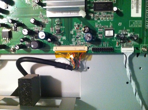

No wires are broken or loose from that part but I do see some wires that look a little funny from j6.Upload
