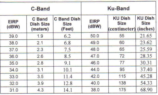

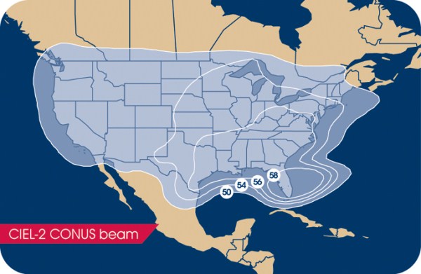

Friday, January 13, 2012 - 02:26 GMT Hi Subash, Can I get HD channels using an 18 inch dish on 129 West
Username: Krishn Post Number: 1630 Registered: Sep-06
Friday, January 13, 2012 - 04:15 GMT Nash: 18 inch is most probably good enough to get HD from 129 West where you live. Try first try by turning a 18 inch dish, if you have one. In case you do not have 18 inch dish - you can get a 24 inch dish.
Username: The_messenger Post Number: 130 Registered: Oct-07
Friday, January 13, 2012 - 13:08 GMT nash h rizvi.......Can I get HD channels using an 18 inch dish on 129 West ? ...........(NO you can't) Minimum size required from your location for Ciel 2 at 129.0°W is 21.65 (inches)
