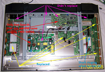

I don't know which board is the "signal" board they're talking about, or if this is the source of the problems, as I'm an ex-owner, not a tech.
But my history is I had a P50HDM which went bad, I took it apart several times and I am familiar with the component layout.
Like all flat screens, the P50 only has about five or six circuit boards (and the large plasma display) in it. Common sources of Vizio problems seem to be:
- DTV board (which contains the actual connectors the cables are plugged into)
- Power board about dead center of the TV, I'm told poor heat sinking often causes these to go bad and deliver spotty voltages to the rest of the PCBs
- Ysus board (several have told me that if this goes bad you should replace both the Ysus and Zsus boards simultaneously)
Anyway, the "signal" board sounds to me like another name for the DTV board. If it ends up you need to replace the DTV board, I have a brand new one I can sell you. I ended up returning my broken P50 to Costco, and have unused replacement boards I purchased still here in the house.

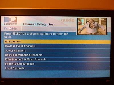

Hello,
I have a L32 HDTV unit I bought in Costco in 2006.
As of last week, I'm having trouble with the image. The color seems tinted pink-ish, with some areas that appear to be saturated, like in negative. There is also some noise and a faint flicker. This happens with all inputs (TV, AV1, AV2, AV3) and it's particularly noticeable when connecting my PC to the TV.
Dale, could this the DTV board issue? How can I be sure?
Here's a picture that might help determine the problem. The top of the image is kind of pink, and it should be white.
Thank you!
Regards,

Username: Capezzani
Registered: Feb-09
I thank you for the good advice, but I'm afraid I'm living outside US at the moment. I bought the TV at Costco and took it back to my home country.
That's why I NEED to fix it, or rather throw it away.
Any help on what might be the problem? The DTV board maybe?
Here's another picture of what happens when I connect my PC. Everything terribly saturated towards pink...
Help!
