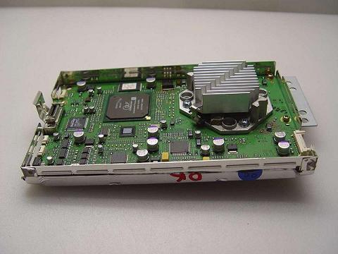

Brandon
I think that it is your DMD board.
If so, I believe it is model (#AA41-00694E), it should work in most HLN models...It worked in mine.
http://www.discount-merchant.com/We-provide-factory-original-parts-worldwide-p/1077996-samsung.htm
Discount-Merchant should have this part for around $180-$200
(SAMSUNG N/A Projection - DMD Board AA41-00694E HLN437W/HLN507W)
DM recommends that you check the old part you have with the part they are selling on their website to make sure you are getting what you need.
Take the back shielding off your old DMD board, there are numbers on the board that you can cross-reference with the photos of the part DM is selling.
Good Luck

Username: Big_d_z
Registered: Apr-09
MSV,
I checked my DMD board. I have version AA41-00694D (L26A).
Do I need to get this exact board? I only found the whole light engine for this version (out of stock) listed on DM.

Username: Msv
Registered: Feb-09
Bill S.
Sorry to here that...I hope that DM will be restocked soon!! You might call them to see if they could do a visual inventory, there might be one hiding in back corner of their warehouse.
Good luck
Brandon,
Glad that you checked your board...from what I understand is that D board is older than the E.
You might be able to upgrade, but the voltage might be different. I would stay with the same board you have just to play it safe.
You can also check with Ovadoggvo who is posting on, http://fixyourdlp.com/forum/viewtopic.php?f=10&t=46&p=209#p209
and may have the answer.

Steve Arric
I think I found the PCB Digital Board here > http://www.discount-merchant.com/We-provide-factory-original-parts-worldwide-p/1 110636-samsung.htm
Samsungparts.com calls out part number AA41-01098B as a PCB Main for the model HLR5067WX/XAA. Enter your Model HLR5067w, which lists some basic parts, in the upper right hand there is a link
> "View Entire Parts List for this Mode"l ,you will find this part there.
If I were you I would disassemble the shielding on your current digital board and find the PCB part number making sure it is the same, warm fuzzy feeling.
On the discount- merchant site you can "Click here to view pictures of this part (if available)." Scroll down is see all angles of the part, including the PCB part number.
I was curious as to why your Digital Board ASSY was twice the cost of mine, when we both the same model, but different revisions. Your board has a different Tuner and splitter and they are not attached to the board, on mine both are attached.

Username: Ovadoggvo
Post Number: 307
Steve,
Here is a link to a Digital Board for your TV that's in stock:
http://www.discount-merchant.com/We-provide-factory-original-parts-worldwide-p/1 107280-samsung.htm
The model number is different, but it should be the same digital board. Please verify that it's the same by looking at the high resolution pictures they have on the site. Also, your servicer may have to re-program the board to fit your resolution since it came out of a 46" TV.

Username: Ovadoggvo
Post Number: 308
Walter,
Does your menu appear with lines in it as well? What about your picture in picture?
If yes, then DMD.
If no, then Digital Board.
I would call D-M to see if they have it in stock. My favorite sales rep there is Sam at x523. He has access to parts that aren't on their website!

Username: Ovadoggvo
Post Number: 309
Joe Key,
The problem is most likely the digital board that controls the menu system... Digital board is the one that has the DNIe chip on it.
Looks like one of these:
http://www.discount-merchant.com/SearchResults.asp?Search=projection+digital

Username: Ovadoggvo
Post Number: 312
Mike G,
You're right... The problem you are having is most likely the digital board.
Claude,
The problem you are experiencing is most likely the digital board as well. The digital board controls your menu system and startup sequence. You're light engine does not need replacing. I would look on D-M for a digital board. If that doesn't solve it, the DMD can also be the source of the problem, however, the chances are 80% Digital Board, 20% DMD board.
Good luck guys!
