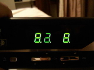

I was trying to set up the WF for the ultra and while installing one of the files my unit froze and not it displays some weird numbers. I dont know what to do.
I turn on the back switch, it shows "----" then it shows "8.6. 8"
The "6" is backwards kind of like an upside down "g"

Here is a picture:Upload

You will have to use the serial cable and Veiwsat laoder.software.
Get any factroy file and install it. You may run into the same freeze up. here is what you do.
Try installing the software, just as you turn on the main power switch, just after just before, etc., till you get the old software to load. Once you have any old factory file loaded, you can proiceed to the newer setup etc.

Got it unlocked.
