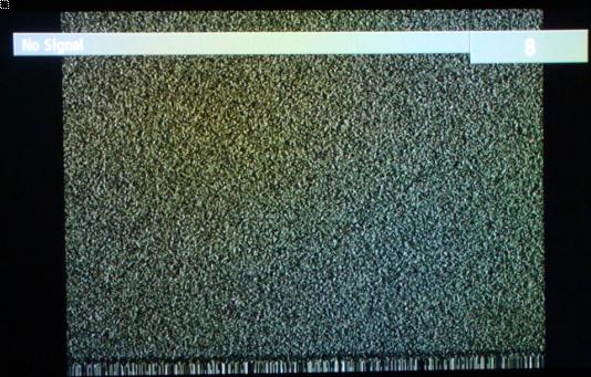

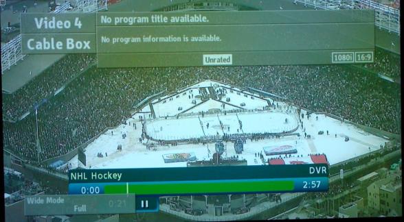

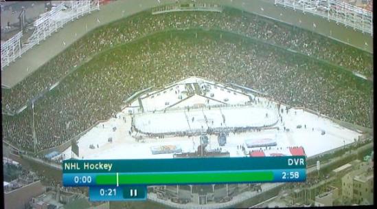

I have a Sony KDS-R60XBR1...nov. 2005 mfg date....the green cast is most pronounced in gloomy gray scenes....it tends to be less noticable and can seem to disappear in regular scenes.....the source of this issue is the plastic LCD color panels in the optical block....the plastic discolors and yellows from HEAT and TIME just like the plastic headlights on a car.....the replacement optical block is refurbed with GLASS LCD panels and will not be subject to this degredation. Sony and other manufacturers that made TVs with these plastic LCD panels will not escape this inherent problem with plastic. They saved money at the expense of every RPTV buyer and killed the market.

By the way, I found my images of my TV anomaly.....here they are, if this works !!
