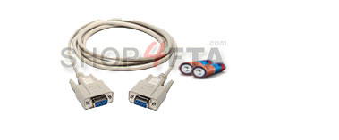

Platinum Member Username: NydasPost Number: 17044 Registered: Jun-06 | Prodigy uses a null cable which is often Black. |
Gold Member Username: GregrafPost Number: 4126 Registered: Dec-07 | Dont look black to me. http://images.google.ca/imgres?imgurl=http://www.shop4fta.com/images/products/kbox-k1-prodigy.jpg&imgrefurl=http://www.shop4fta.com/kbox-k1-prodigy-fta-satellite-receiver.php&usg=__19MfCgCVf-09HB2LXWMcDaK15eg=&h=400&w=500&sz=39&hl=en&start=2&um=1&itbs=1&tbnid=yRhFY8GxEmFeqM:&tbnh=104&tbnw=130&prev=/images%3Fq%3Dnull%2Bcable%2Bfor%2Bkbox%2Bprodigy%26hl%3Den%26rlz%3D1C1CHNU_enCA356CA356%26sa%3DG%26um%3D1 |
