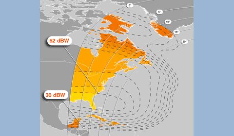

AB 1 @ 12.5W - NA Beam
Username: Plymouth
Post Number: 11782
Nalin
From Montreal we can get as far that 1.0W Intelsat 10-02 on C-Band, personaly I get satellite listed by Capt Hook.

Chumley and Plymouth:
Thank you for correcting me. I am accepting your information without further investigation.
I have had frineds in Halifax area, trying some of the sats mentioned as "Atlantic" in the Lyngsat main page (East of 61W), with varying success, but not in Toronto. To that extent I was wrong in making a statement about whole of North America based on Toronto area.
I also found that larger dishes were needed and you were scanning C band mainly. However that was over 2 years ago and my memory is dim about the actual testing in detail..
