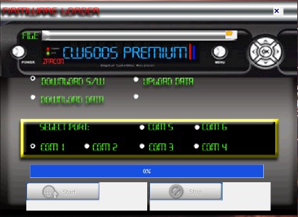

Gold Member Username: DoreenakadjOntario Canada Post Number: 3250 Registered: Dec-06 | when using the loader check the com port use this to see what ones are open and make sure it matches the loader com port ( com 1... com 2 and so on....)if you are using a serial cable it is com 1 if your using a USB cable try com 3
Gold Member Username: DoreenakadjOntario Canada Post Number: 3251 Registered: Dec-06 | plymouth why go to boot mode? Standyby mode = Turned on the unit from the back and turn ON the power button on the remote ( if power button doesn't work on the receiver) and it goes into --:-- (the clock) also known as STANDBY. your receiver is now in standby and ready to load the bin. thats all you need to do oh and any cw loader is good and will work. 107 is the latest one |
Gold Member Username: DoreenakadjOntario Canada Post Number: 3252 Registered: Dec-06 | 107 loader ![]() |
