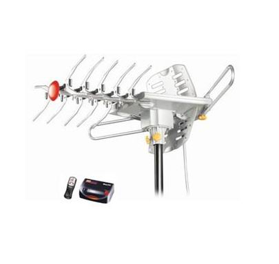

Gold Member Username: TapemanNew York Citay in-HD, NY Post Number: 4501 Registered: Oct-06 | Terrestrial tuner has a different coaxial input from Satellite input 2 different independent coaxial inputs Ant input has no DC voltage driver control Sat input uses 14/18v selectable inputs DC voltage is what controls DISEqC switch Sonic View FTA receiver has MPEG-2/MPEG-4 with Terresterial tuner I don't know why yo'll need 4 antennas? Check this antenna http://www.lavasat.com/product_detail.php?proid=44 I paid $40 for this antenna It has a built in motor and a great amplifier + remote control to move It's both UHF/VHF 90 mile radius If yo still want to use all 4 antennas Then what you need to connect all 4 with a signal combiner (4 way splitter) Yo put all 4 coax antennas in (1 to each connector) And one output goes to yor FTA Antenna input Either method should work like a charm |
