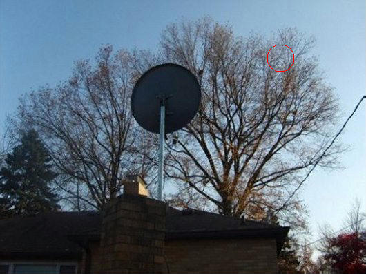

Bronze Member Username: YalfaressPost Number: 18 Registered: Oct-09 | Plymouth, Here are the pics i took for my dish and LNB. ![]() |
Silver Member Username: El_toro_the_greatNC USA Post Number: 204 Registered: Jul-09 | yaser alfaress Your Azimuth (True North) is 196.7. but your Compass Reading should be 200.7 you need to add your Magnetic Deviation West 3.87 ![]() |
Silver Member Username: El_tora_the_greatPost Number: 188 Registered: Sep-09 | yaser my brother toro Is one of our best helpers.Plymouth Is a troublemaker. |
Bronze Member Username: YalfaressPost Number: 19 Registered: Oct-09 | Plymouth, here are the other pics I took. For whiskey, I am not using a compass and using 196.7 and elevation 42.5 but still no quality. By the way, I am not too worried about troublemakers since there is nothing illegal about true fta. |
Platinum Member Username: PlymouthCanada Post Number: 11555 Registered: Jan-08 | yaser It seem that your dish is in direct line with the big tree on back of the picture. I'm not able to found your LNB type! Try those 2 satellites: www.lyngsat. com/amc1.html www.lyngsat. com/amc21.html ![]() |

Platinum Member Username: PlymouthCanada Post Number: 11556 Registered: Jan-08 | Your dish point on red circle ![]() |

Bronze Member Username: YalfaressPost Number: 20 Registered: Oct-09 | Well Plymouth, my dish in the picture is actually pointing to the true south. When I move it to the west(right) to try to get 97w, I get no quality. The reason I left it pointing south is because I got tired of messing with it, so the true south will be my reference point when I try to point it later. Do you need a better picture of the LNB to determine what type I have?? |

Silver Member Username: BernardmiPost Number: 713 Registered: Dec-07 | Yaser I can assure you your tree should not present major attenuation of the signal. It is cleared enough of its vegetation. You should not have problems getting 97W. My own backyard looks like yours and I am receiving 97 loud and clear. |
