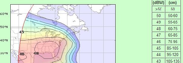

OK he lives in Indiannapolis
Yes his 65cm antenna should do the work.
Username: Bernardmi
Post Number: 700
Here is a better image that shows more contours.
Username: Bernardmi
Post Number: 701
The arabic channels are amongst the strongest on Hispasat along with the Cuban and Columbian channels. He should have no problem with his 65cm antenna.

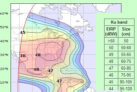

Username: Bernardmi
Post Number: 702
Sorry,,,, Yaser mentioned he had a 76cm antenna and not 65. Misread.
At this size, he should have no problem at all.
