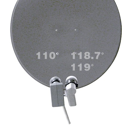

Platinum Member Username: PlymouthCanada Post Number: 11462 Registered: Jan-08 | Danda Do you have a picture of your dish or bracket? |
Bronze Member Username: CanadastarPost Number: 11 Registered: Oct-09 | I don't have one handy, but I can take one. It is almost same as picture put out by Whiskey on htis thead. |
Platinum Member Username: NydasPost Number: 16420 Registered: Jun-06 | You do need a new LNB for 110W. The old installations were 110/119 on one LNB and 121 on another. The new installations are 118/119 on one LNB, 110W on a second LNB and an optional 129W on a third LNB |
Bronze Member Username: CanadastarPost Number: 12 Registered: Oct-09 | Assuming I need to replace existing 110/119, How do I know which exitsting LNB is for 110/119? |
Platinum Member Username: NydasPost Number: 16423 Registered: Jun-06 | The LNB with two seeing eyes is probably 110/119 LNB. |
Platinum Member Username: NydasPost Number: 16424 Registered: Jun-06 | You can use the existing 110/119 for just 110. Or us can use current 110/119 and add to it the 118/119 and use it only for 118. You don't need the 121. That LNB is definitely redundant. |
Bronze Member Username: CanadastarPost Number: 13 Registered: Oct-09 | Thanks for the advice. Only part I am confuse about is, LNB for 110/119. Hopefulley I don't pull the wrong one out. Then no harm trying either one to see if I can catch 119 or 118.7 with new one. |
Platinum Member Username: NydasPost Number: 16425 Registered: Jun-06 | Look at the picture above. Where it says 110 is where you will currently have a 110/119. Replace that with a 118/119. To the right where in the picture it say 118/119, is where you currently have the 121. Remove it. The final installation picture will look like what is posted above, except it could be 110/119 and 118/119 side by side, if you do not want to buy a new LNB just for 110 |
Platinum Member Username: PlymouthCanada Post Number: 11466 Registered: Jan-08 | Danda Your DGL 1189 is made to get 119 and 118,8 on same LNB, put it in the center of your bracket and realign your dish with this LNB on 118.8 then add your 110 LNB and and align this one, this is the way to obtain the best signal on Both LNB. Like other says 121 is useless! ![]() |
Bronze Member Username: CanadastarPost Number: 14 Registered: Oct-09 | OK Folks. Just to give you an update. Before I was about to replace my old LNB, I tried to play around with SW port on dish settings with old LNB on. It turns out that, I can actually get 118.8 and 119 with my existing LNB. And It happend to be the one on center, not the one on left as it shown on the picture. Therefore I left it alone and didn't replace it. But I did pulled out my 110 LNB prior to that. Now I am getting 91 on small dish and 118.8 and 119 on big dish. I am planing to put back my original 110 LNB. I hope it will work. Thanks for all your help. Cheers. |
