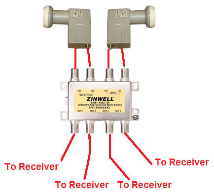

New member Username: AlbertwhitePost Number: 3 Registered: Oct-09 | I want some information on satellite TV services. I know about some basic services rules but I just want to clear my points. I hope I found some more unique information. Thanks. |

Platinum Member Username: NydasPost Number: 16382 Registered: Jun-06 | albertwhite: 1. Yes, you can use one dish for the whole house. 2. You can ignore most of of the above C/P. If you are going to use any FTA receivers, you will notice in the above setup, that you are required to have one DN supplied receiver on all the time and that is unrealistic. 3. If you already have a Dish receiver and you want to go that route, fine. Otherwise, you should use a DP44 or similar 4 x 4 switch which has a better power supply situation. This switch will give you four inputs for four different sats , and 4 outputs to a total of four different locations within the house. 4. You want to use one dish only. You should get a 33" or 36" dish. You can mount a combo 118/119 LNB, a 110 LNB and a 129 LNB on it. There are wide dishes available for 4 LNBs, but you will not get 118W accepted properly on those. A wide LNB will get you 82W, 91W, 110W and 119W or 91W, 110W, 119W and 129W (with a bit of luck). 5. If you want to stay Dish Network only, you can get a 1000+ setup with 118/119,110 and 129. Note that this is the Plus setup. |

New member Username: AlbertwhitePost Number: 4 Registered: Oct-09 | Thanks for all of your help.I heard that direct tv will also provide this type of facilities?so i want to know that what is difference between dish tv and direct tv?Do they use different technologies for signal? |
Bronze Member Username: Watch_dogPost Number: 59 Registered: Apr-09 | albertwhite Do they use different technologies for signal? NO only System encryption DirecTV uses Videoguard Dish Network Nagravision 3 |
