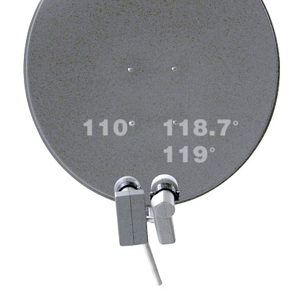

Ok guys, after reading some more, I think to get 118.7, I have to buy two new LNB's
1) Circular Dual Band LNBF for 118.7° & 119°
2) Single LNBF for 110°
Even after using these two new LNB's with dish-500, I may not get all the channels on 118.7 .. but I will get some on 118.7 and (110&119) should be okay? is that right?
After buying these two LNB's can I just replace my current LNB with these two new ones (without having to adjust the dish.. since dish is already aligned for 110 and 119)?
How many cables am I going to need? One for circular LNB and one for 110? Can I then connect these two cables using a switch so that only one cable is coming inside of the house?

You need a 30-33" Dish. One special LNB for 118/119. You can use the old LNB just for 110. You are better off with a separate two output LNB for 110 and then process the signals through two DisEqC switches, because your new 118.119 already comes with two identical outputs.

Should I buy a new bracket to attach the new circular LNB alongside my current twin LNB? Or can I take out the 119 portion from my current LNB and put the circular LNB in its place?

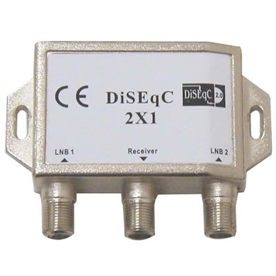

If I use two DisEqC switches (for the case when I use dual lnb for 110 & circular dual for 118/119), there will be two cables coming inside.
If I want only one cable to come inside my house, do you think I can just use one DisEqC switch outside, and then split the cable inside my house to go to two different receivers? I am not sure how to split the cable inside my house :-(

MECHANICAL CONSIDERATIONS: I have only this for Superdish.
CB2008A cannot directly replace the 119 LNB on the Superdish. Superdish lnb for 119 has a special bracket. If you are good mechanically ,you could probably figure a way to mount it on the Superdish; - it is not impossible. Iit requires a rectangular mount similar to those of DTV. The mount for Dish LNB have one side that is semicircular.
Switching You will have to get two cables for two receivers. One cable cannot be split inside the house for two receivers.
The following gives mounting on a generic Dish - IT WORKS. I think Transat sell Digiwave DGL1189.
http://transatelectronics.com/store/33inch-dish-for-110-1187-and-119w_P321
With your 500 Dish you will have to figure out the brackets. I would still discourage you and suggest NOT to waste time with 500 Dish. 30-33" dish is the way to go. 500+ or 1000+ is what Dish recommends.

that lnb has a built in switch
here is the solution
get a single 110 lnb and a special
circular 118/119 lnb
now replace these two with the one you have
you will need 3 cables, you already have one so run 2 more.to a dp34 switch
and run one cable from port 2 of switch to receiver
and leave your sub on port 1 of switch and leave
the sub receiver powered on at all times
lnbs should cost you about $ 40 for both or cheaper,and dp 34 switch about $ 40

@Africanbrit do you think I can mount these two separate LNBs (110 & 118/119) on my current dish-500? I am not sure of brackets and all.. what kind of brackets will I need to mount these on dish-500?
If I can mount these, then your solution looks very good.

with your existing dish you will not need and brackets
you will remove the lnb from the yolk ( which is the bracket) that is already there and put the new lnb's there

1. DP34 does not work with CB2008A. I do not know if it works with Digiwave DGL1189. This info is related to the special LNB for 118/119. There are non-DN, 3 input 4 output switches available.
2. If you are buying a DiseqC switch, 2 to 1 and 4 to 1 switches are about the same price, so i suggest you buy 4 to1 disEqC if you need a swtich of that type.
3. If you are only going to use one receiver at a time, you can loop out from back of receiver.

I guess i can order a 4x1 DiseqC switch too.. its very cheap.. but this DP34 may go waste
