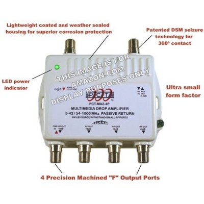

No Splitters only this amplifier.
Connecttions:
RF IN (top right) The connection coming
from the Cable Company
(Top Left ) connection to the power supply.
Outputs (bottom)
Amplifier outputs connections for my three TVs.
