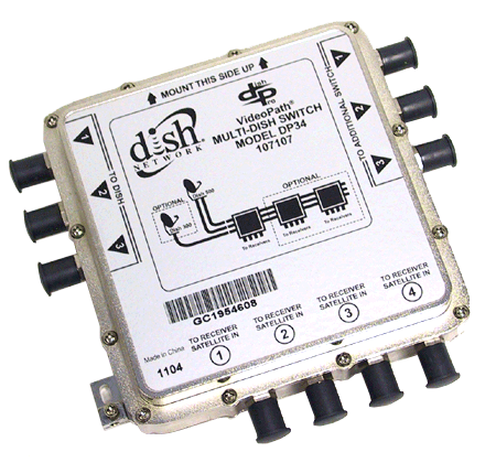

Username: Nydas
Post Number: 16180
said aozal: You may not find it easy to change the LNB. I am a practical person, and there is always the likelyhood of your needing additional dish or LNB for another sat.
I suggest therefore that you buy a simple 3 input 4 output switch. This kind of switch allows you to have three satellites coming in and distribute them to any of 4 receivers.
You may be able to achieve the solution inside the house, by attaching the new 3/4 switch inside the house and connecting the two receivers. You will be using only one of the three inputs.
The ideal place for a switch like the 3/4 is close to the LNB. Buy a short cable (three to four feet will do) with appropriate ends to run it from the LNB to the switch. Connect your current cable to one of the outputs and run a second cable from second output to second receiver.
Try in the house method first and if not successful try the second method on the roof.

Username: Nydas
Post Number: 16192
sump: For your education.
"why do you get a 4x1 switch with your reciever ? "
You get a 4 x 1 switch so that you can have four LNB inputs in the switch, and channel them into your newly acquired receiver. That is what I found your answer puzzling. This guy want to direct one LNB output two two receivers. For a cost of about $25 he would get a 3/4 switch and solve his problem at the same time have surplus spca for additional two LNBs input and two more receivers output.
In the past you have made some unacceptable statements and again you are coming with lack of some basic knowledge.
4 x 1 diseqC = 4 LNBs to one receiver.
3/4 switch = 3 LNBs to 4 receivers.
GET IT???
Username: Nydas
Post Number: 16193
Sump:
3/4 multi-switch
http://www.centralsatellite.com/productview-521.html
"This Mult-Switch Splitter combines two LNBs and one off-air or cable into into 4 outputs. All unused ports of the VM3400 should be capped (terminated) using 75 Ohm Terminators. This will reduce "ghosting" , interference of off-air signals, weather damage and lockups."
4-1 DiseqC switch
http://www.inverto.tv/products/product.php?section=3&id=140
"This small and reliable 4 into 1 DiSEqC switch will enable the reception of signal from 4 satellites and their distribution to a single tuner Set-top box with only one cable entering the house."

Username: Nydas
Post Number: 16196
Idiots:
The MOST standard practice in FTA world for viewing from two receivers is to have a multiswitch capable of powering at least two receivers.
The most frequent thing that people often do is to add another satellite because of certain need for extra channels.
Combine these two needs and you end up with a multi-switch capable of handling 3 sats and outputing to 4 receivers.
Joker: You never run two wires directly from one LNB to two receivers - you will get problems with both receivers.

Joker: sorry for you but it is more convenient to try a 3/4 mulit-switch inside the house. We know that it WILL do the job.
DISH Network DP-34 VideoPath Dish Pro 3x4 Multi-Dish Switch (DP34) 107107 Works with Dish 300 and Dish 500 satellite systems. Can be used to cascade additional DP34 multiswitches for more receiver outputs. Can only be used with DishPro LNBFs.
Availability: In Stock Our Price: $74.99

There is only one Stupid Retard on this forum
That's yo aribian boi
This switch is a polarity stacker
It passes both V&H polarity on one coaxial if the LNB is dual to start
It converts 14v(V) and 18v(H) to one common stack of 20V(V&H)
Basically works only with Dish Net power supply and accessories
I see yo know nothing about it to compare it with a 3x4 Sw

If you are using a FTA receiver, avoid using a DP34. Use the switch suggested by Plymouth.
http://www.sadoun.com/Sat/Products/S/S-SM34-3x4-multi-switch.htm
If you have a Dishpro LNB and two Dish receiver, you should use a DP34.
All connections can be made inside of your house.

From a practical point of view, IT DOES NOT MATTER WHETHER THERE IS A DUAL OR A SINGLE LNB
The method I have described requires very little effort, no climbing on the roof, very little cost and a 100% chance of success for a novice.

A 3/4 switch is designed primarily for three inputs (2 LNB + Antenna or 3LNB) and outputs to four receivers. It does not mean that you have to populate all the inputs and use receivers on all the outputs
Therefore, whatever signal(s) are coming down to him can be distributed by a 3/4 multiswitch to four receivers.
If it is D/N LNBs then use DP34 and Dish receiver. If it is non-DN LNB coming down then use a 3/4 multiswitch.

King, would you kindly let us know what would happen if only one sat e.g 119W was connected to this. Will two (or 3 or 4 receivers) work?
http://www.prosatellitesupply.com/dish_network_dp34_switch.htm
Combines 3 Orbital Locations to power 4 Receiver Outputs
Features
'¢ Three inputs to capture signals from three orbital locations (61.5°, 105°, 110°, or 119°).
'¢ Four outputs for connection to four single-tuner receivers. (Any combination of single and dual-tuner receivers can be connected however, dual-tuner receivers act as two separate receivers and require connection to two ports.)
'¢ Three "cascade" feeds to cascade to other DP34 switches. Up to three DP34 Switches can be connected in a cascade to feed up to 12 single-tuner receivers.
'¢ Switch is powered by receiver. Does not require AC/DC power insertion.

"Dishpro question only.
King, would you kindly let us know what would happen if only one sat e.g 119W was connected to this. Will two (or 3 or 4 receivers) work?"
Well, this is an excellent question
From what gathered
- Each LNB on all D#N is a dual LNB to start with
- Internal circuit board that connects each LNB it does something called stack polarity
Meaning it takes both 14v, 18v polarity on a new stack polarity of 20V via one coaxial cable instead of 2, voltage is collected via DP34 or DP44
- They use a separator 123254 for dual tuners if they need to split it
D#N perfected this process to send in particular for DVRs in multiple rooms on one coaxial
Now keep in mind this separator works with DishPro LNBs only, DP34 or DP44, the separator when required
The new black HD receivers has built in separators for dual tuners
I hope this answers yor very good question

also from Nalin's link in the PDF file
"The DPP Separator is with with DPP LNBs & DPP switches only. A DPP Separator can placed
on a single RG6 cable to output to a dual tuner receiver. Most FTA receivers do not support the
separator so does not work with FTA systems.
The Sonicview 360elite PVR is the only FTA receiver that DPP Separators work with so far,
however as new models come out -- more will support the DPP Separator."
also you need 2 of these switches ..one on the roof and then another @ the reciever to unsplit the signal
this will not work for 2 separate receiver boxes IMHO
DP PLUS LNB's add a whole other level of discussion ...
the solution STILL puts you ON THE ROOF !!
POST # 3 in this thread was and is the answer until information was given from user

http://sadoun.com/Sat/Products/JVI/35-DN34.htm
this is not a 3x4 switch it is a DP 34 MULTI SWICTH
yea yea yea another typo !!!
it was 1 of the solutions i said in post #3

A DP34 is a 3X4 multiswitch made for Dn

We have already proved that my suggestion of a DP34 for Dishpro receiver will work. It is a simple matter of a DP34 with only one LNB attached to it. it will distribute the signal to 2-4 receivers. QED.
Next question to King please.
This guy said aozal has one cable coming to his receiver and he has all the channels on it. From that description what kind of LNB and setup he might have?

This is not the solution to hook 1 receiver to 1 Dual outputs LNB but it can work.
Read the total thread and see the majority says only to installed a new cable.

SUMP SAID ....
No NALIN and Plymouth ...
1) 3x4 switches are all the same that's why there called 3x4 and not 4x1 or 4x4
2) you MUST have a DUAL LNB to use it, one wire from the roof will NOT work on a 3x4 switch in the basement
3) IF he does if fact have one dual LNB running one wire from each port to each receiver will absolutely work fine
4) the most likely thing he probably has is a twin or 2 singles up there with a diseque on the roof and one wire coming down with the recievers tied together
so with that said someone needs to get to the dish, one new wire needs run from the sat to 2nd reciever,
based on #4 adding a 4x1 to the existing setup and running new wire to 2nd is the best solution and will allow for future expansion or
based on #3 running new wire to 2nd box is the best and will allow for future expansion
